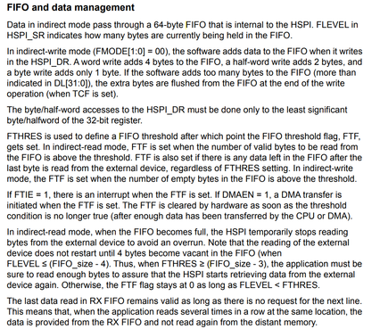

My problem is that I am not seeing the expected fixed Id register contents when I read the HSPI_DR.  The expected Id register value is seen on the bus with the logic analyzer.  I have dug in enough to understand that the DR read actually pulls from a 64 byte fifo, and that the number of bytes in the fifo are indicated by the contents of HSPI_SR:FLEVEL[0:6].  I have checked the fifo level before initiating a 2 byte HperBus read, and see 0.  I initiate the transfer by writing the HSPI_AR register and immediately after the transfer, FLEVEL indicates 30 bytes in the fifo.
A bit of test code to pull these 30 bytes into a debug array shows 28 bytes of 0, with the expected psram ID value in the last two bytes of the fifo.  I have 7 clocks specified for tacc = initial access latency (STM RM0456 Rev 5, Figure 169).  The psram holds RWDS high to request a second set of 7 latency clocks.  This gives 14 latency clocks, or 28 clock edges.  If I increase the number of latency clocks, the number of extra bytes in the fifo increase correspondingly.
It looks like the hspi in HyperBus indirect mode is receiving data on the latency clock pulses and storing in the DR fifo.  Has anyone else seen this, or been able to get hspi HyperBus indirect register space access to work on the STM32U5G9?

About the FIFO in indirect-write mode, data written to the HSPI_DR register is stored on the FIFO before it is sent to the external device during the data phase. If the FIFO is too full, a write operation is stalled until the FIFO has enough space to accept the amount of data being written.
In indirect-read mode, reading HSPI_DR register gives (via the FIFO) the data that was received from the external device.
If the FIFO does not have as many bytes as requested by the read operation and if BUSY = 1, the read operation is stalled until enough data is present or until the transfer is complete, whichever happens first.
For more information about the FIFO characterization please take a look at RM0456 section FIFO and data management and to this FAQ.

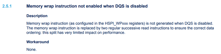

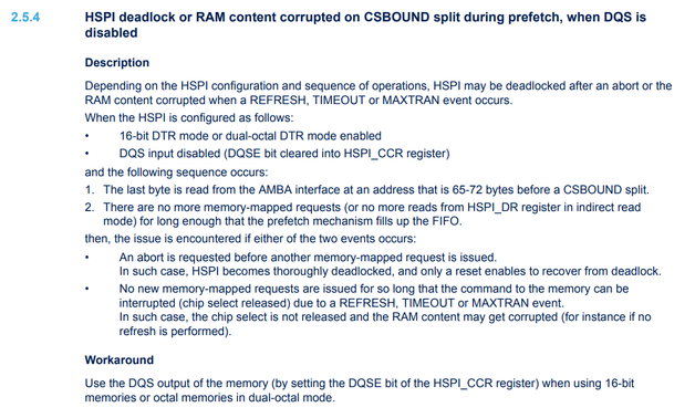

Hello @rdl_42 ,
Thank you for updating post.
Could you please take a look at these erratas.
Are you in this case?
Thank you.
Kaouthar
@KDJEM.1 ,
Thanks for the references to errata.  I am running with DQS enabled, so I don't think either of these apply.  I have continued to adjust register settings, and am now able to read all needed addresses in register space, and read/write the actual device memory in indirect mode.
