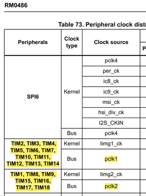

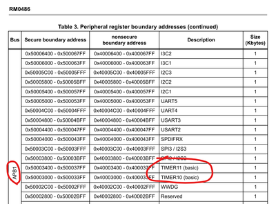

2025-07-23 4:58 PM
Go to the reference manual in the "Peripheral register boundary addresses" table and you can see which timer is within which APB.
The "timer group clock" is a separate clock you can use to clock individual timers. See timgx_ck below
It's also listed here which PCLK goes with which timer:
2025-07-23 5:21 PM - edited 2025-07-23 5:30 PM
I missed that in the "Peripheral register boundary addresses". I guess I do not know what "PClkx" is and where it comes from. I am using STM32CubeMX and am confused on how to set the clocks for the timers. Nothing seems to match with the documentation. What are the "Timer Clock Group" clocks.

2025-07-26 9:47 AM - edited 2025-07-26 9:48 AM
I was told by the support team at ST that this is not true. The "Timer Group Clocks" actually drive the timers.
"Yes, the clocks are connected PCLK1 and PCLK2, as shown in the reference manual. I know the term "Timer Group clocks" is vague, but I think we can deduce what it does by looking at the definition of TIMPRE register field:
Bits 25:24 TIMPRE[1:0]: Timer clock prescaler selection
This bitfield is security-protected by a SEC signal from RIFSC, the SYSSEC bit, a PRIV
signal from RIFSC, or the SYSPRIV bit, and is publicly readable if SYSPUB = 1. It is set and
reset by software to control the clock frequency of all the timers connected to APB1 and
APB2 domains.
00: timg_ck = sys_bus_ck (default after reset)
01: timg_ck = sys_bus_ck / 2
10: timg_ck = sys_bus_ck / 4
11: timg_ck = sys_bus_ck / 8"
Look at "Figure 45. Core and bus clock generation" for the divider and resultant timer clocks.
