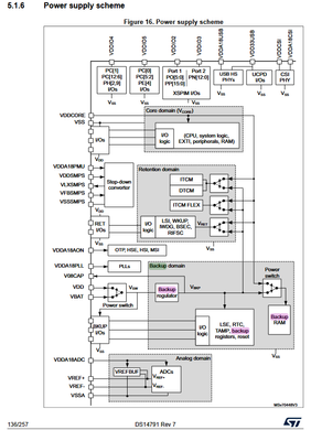

In AN5967, it says:
When VBAT is connected (VBAT = 3.0V)?  will the oscillator (RTC) stop running if VDDA18AON is not present?
There are several conflicts between the various documents... Can someone at STM update the docs?
AN5967,  RM6486, UM3300, and the STM32N657x0-dk development board schematics seem to contradict each other.... which one is correct regarding the SMPS configuration?

The RTC [clock] and LSE [oscillator] are in the Backup domain for most STM32 devices:
So VBAT or VDD is needed to keep those operating.
