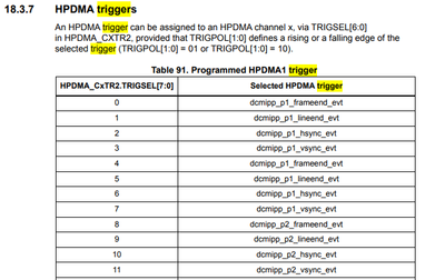

Yes, sure, you can use the DMA to transfer the data from the Odd/Even destinations to the new output buffer dedicated for the progressive frame instead of overloading the MCU.
For synchronization, you can use the dedicated DCMIPP - GPDMA or HPDMA triggers available for the events generated by the DCMIPP (lines, frames, VSYNC, etc.).
See HPDMA/GPDMA triggers sections in the referance Manual
