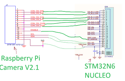

Is there any chance ST could provide examples or guidance on interfacing a CSI (MIPI) camera with Raspberry Pi Camera Module 2 NoIR cameras?
From my initial research, it seems the CSI connector uses the same pin layout as Raspberry Pi cameras. However, available examples are quite limited, making it challenging to implement this on my own — especially compared to the simplicity of working with DCMI.
Any documentation, sample code, or community insights would be greatly appreciated!

Hi @Linas L  Can you please help me understand how you connected Raspberry Pi Camera Module 2 NoIR to STM32N6 eval board, as Raspberry Pi Camera Module 2 NoIR has 15pin but STM32N6 board has 22pin
Simple.
Pi5 has special cable for this. You can buy it in mouser/digikey. Since just like pi zero, pi5 use same 0.5mm pitch connector on pcb
Wow nice! Thanks Linas for sharing this.
can you please share Digiky/Mouser link that I can buy ?
In this cable, the VCC from pin# 15  has been mapped to pin#22 ,right?
