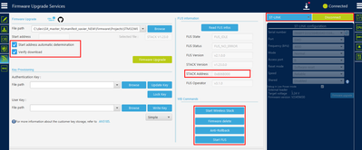

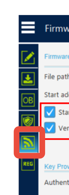

  • On your left you will have this menu on the STM32CubeProgrammer GUI, select it:STTwo32_0-1756507492959.png
  • On the new menu:STTwo32_1-1756507587347.png
    go to file path selector and select the path of the stm32wb5x_FUS_fw.bin. After  that click on the firmware upgrade button and wait until the end of this operation.
  • After that select the local path of the stm32wb5x_BLE_Zigbee_RFD_dynamic_fw.bin and click on the firmware upgrade button.
  • After installation, click on the button Read. FUS infos and you will see the stack address that will help you to understand which Stack is working on the CM0+ of your MCU (comparing this value to the starting address of the .bin stack files available on the Release_Notes.html of the stack and fus .bin files. You can also check the FUS Version installed on the CM0+.
  • Before leaving, click on the Start wireless stack button.
Now, you can upload your application using the CubeProgrammer standalone or the version integrated on the STM32CubeIDE.
