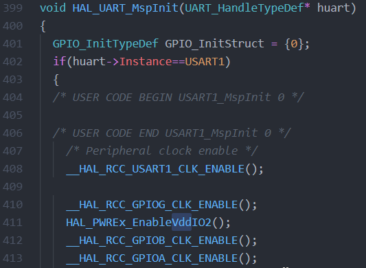

According to my CubeMX project, the following should be done:
So I added that on my initialization:
__HAL_RCC_GPIOG_CLK_ENABLE();
HAL_PWREx_EnableVddIO2();
... same stuff as before
Still no output on the PG9.
waclawek.jan
PWR clock was enabled before that command? Read back the related register in debugger and check.
Is the VDDIO2 pin physically connected to power supply?
LPers.847
Hi @Community member​
The VDDIO2 pin is physically connected to the power supply.
Now it's working, it was missing the enable PWR clock call.
