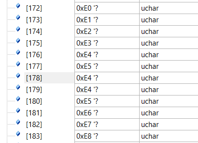

1.I have tried different clock phases.FRAM only supports modes 0 and 3.It doesn't solve the problem.
2.I read data from SPI in two different ways. The first is DMA read,as shown in figure 1.The second is query read,as shown in figure 2. Both of these different approaches can lead to errors.
3.My experimental condition was to write 0 to 255 to FRAM and then read the 256 bytes from FRAM every few milliseconds. When repeated hundreds of times, an error occurs.
4.I have tried to read data using SPI emulation and have no such problem.
5.I present the key code for both approaches below

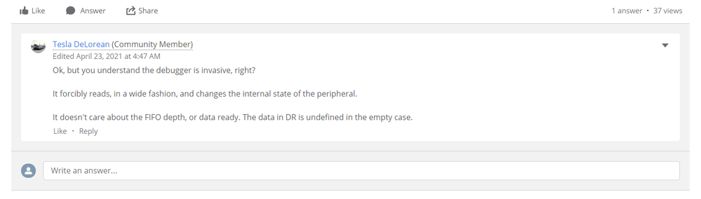

I wonder if this is related to the system clock. My system clock is 2MHZ. I have also tried an 80MHZ system clock and errors are less frequent, but they are not inevitable. I look forward to your reply. Thank you.
2021-09-02 3:04 AM
Hello, my problem has been solved. I saw one of your answers in the forum, so I didn't use the online debugging method to observe variables. I think maybe STLINK is consuming my CPU resources and my system clock frequency is only 2MHZ. Thank you very much .
