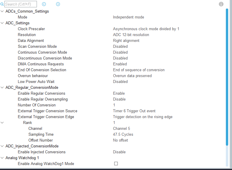

Some background on the steup I am using CubeMX with the latest STM32L4 FW package to generate startup code. The ADC is sampling off of timer 6 at 16khz and running off of an 80MHz clock, I have tried various sample time configurations currenlty using 47.5 cycles. The ADC is running on DMA into a circular buffer. I have tried casting this buffer as both signed and unsigned int16 and neither has changed the outputs. Below is a screen shot of my CubeMxSettings for the ADC.

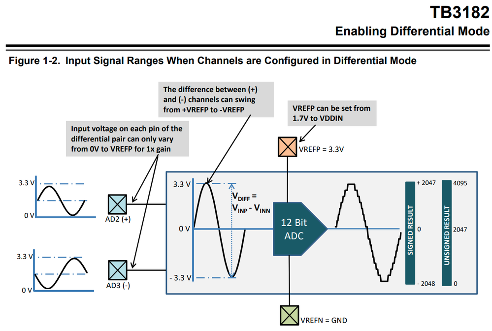

I think the issue is that the output in SE mode should look the same as the output in differential mode, for this particular signal comparison. But you are simple noting that they look the same and therefore it's not working. Hook up VREF- to ground and you'll see a difference.
In differential mode, an output around mid-scale indicates a voltage of 0V, not VDD/2.
Also, as noted above, there is a factor of 2 difference in amplitude in differential mode compared to single-ended.
Also:
http://ww1.microchip.com/downloads/en/DeviceDoc/90003182A.pdf

Range is VREF in single- and 2 * VREF in differential mode. If you use differential mode as pseudo-differential ( one input at a fixed voltage), you loose one bit.

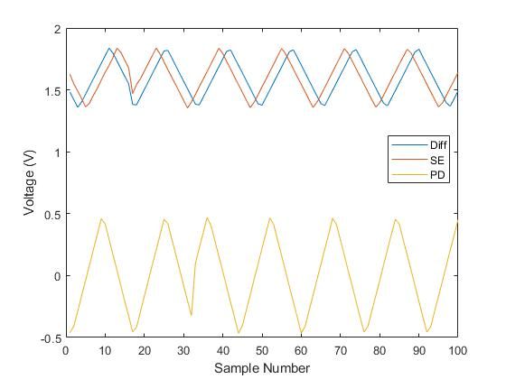

Here is a plot of the voltages. The input signal is a 500mV pk-pk triangle wave centered around 1.65V, 1/2 VDD, with an inverted copy present on the negative input. When the ADC is configured as differential input it is not showing a subtraction between the two inputs but showing as if it is a single-ended input or subtracting from Vrefn, 0V. I expected an ouptut similar to the PD where the output is the P - N inputs. 0693W000005CAR1QAO.jpg

Yeah this seems to be the key, I was doing a conversion as one code = VREP/2^12 when in differential mode it should be one code is VREFP*2/2^12. Thanks for the help clearing this up.
