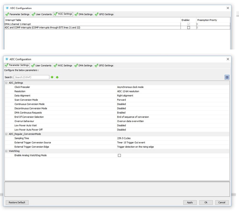

I have an 091, scan mode is on, but continuous conversion is off.
void HAL_ADC_ConvCpltCallback(ADC_HandleTypeDef* hadc) {
 if(!ADC_ChannelsCounter--) {
 ADC_ChannelsCounter = ADC_ChannelCount;
 HAL_ADC_CompleteCycle = true; // signal foreground to process
 for(int i = 0 ; i < ADC_ChannelCount ; i++)
 HAL_ADC_Channel_Buffer[ADC_RowCounter][i] = ADC_DMABuffer[i];

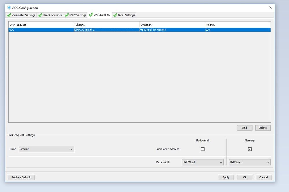

Posted on January 19, 2018 at 13:52
Here is some extra info in case it is useful.
 DMA configuration and ADC GPIO configuration as it is in the source code:
    GPIO_InitStruct.Pin = GPIO_PIN_0|GPIO_PIN_1|GPIO_PIN_2|GPIO_PIN_3;
    GPIO_InitStruct.Mode = GPIO_MODE_ANALOG_ADC_CONTROL;
    HAL_GPIO_Init(GPIOC, &GPIO_InitStruct);
    /* ADC1 DMA Init */
    /* ADC1 Init */
    hdma_adc1.Instance = DMA1_Channel1;
    hdma_adc1.Init.Request = DMA_REQUEST_0;
    hdma_adc1.Init.Direction = DMA_PERIPH_TO_MEMORY;
    hdma_adc1.Init.PeriphInc = DMA_PINC_DISABLE;
    hdma_adc1.Init.MemInc = DMA_MINC_ENABLE;
    hdma_adc1.Init.PeriphDataAlignment = DMA_PDATAALIGN_HALFWORD;
    hdma_adc1.Init.MemDataAlignment = DMA_MDATAALIGN_WORD;
    hdma_adc1.Init.Mode = DMA_CIRCULAR;
    hdma_adc1.Init.Priority = DMA_PRIORITY_MEDIUM;
    if (HAL_DMA_Init(&hdma_adc1) != HAL_OK)
      _Error_Handler(__FILE__, __LINE__);
    __HAL_LINKDMA(adcHandle,DMA_Handle,hdma_adc1);
Also I am using the V1.10 pack for the STM32L4 family on cubeMX.
Posted on January 19, 2018 at 13:35
Thanks for the reply T J. Unfortunately if I disable continuous mode, I'll just get one set of results. Only one conversion of the 4 channels takes place (or whatever it is doing since the values should be 4095 0 X X ... and I get X X X X and sometimes 4095 X X X).
