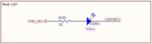

PC13 has limited current driving capability, although the provided circuit appears to be high impedance at the pin. Perhaps take an analog capture of the pin output and related pin outputs during the even for more information.

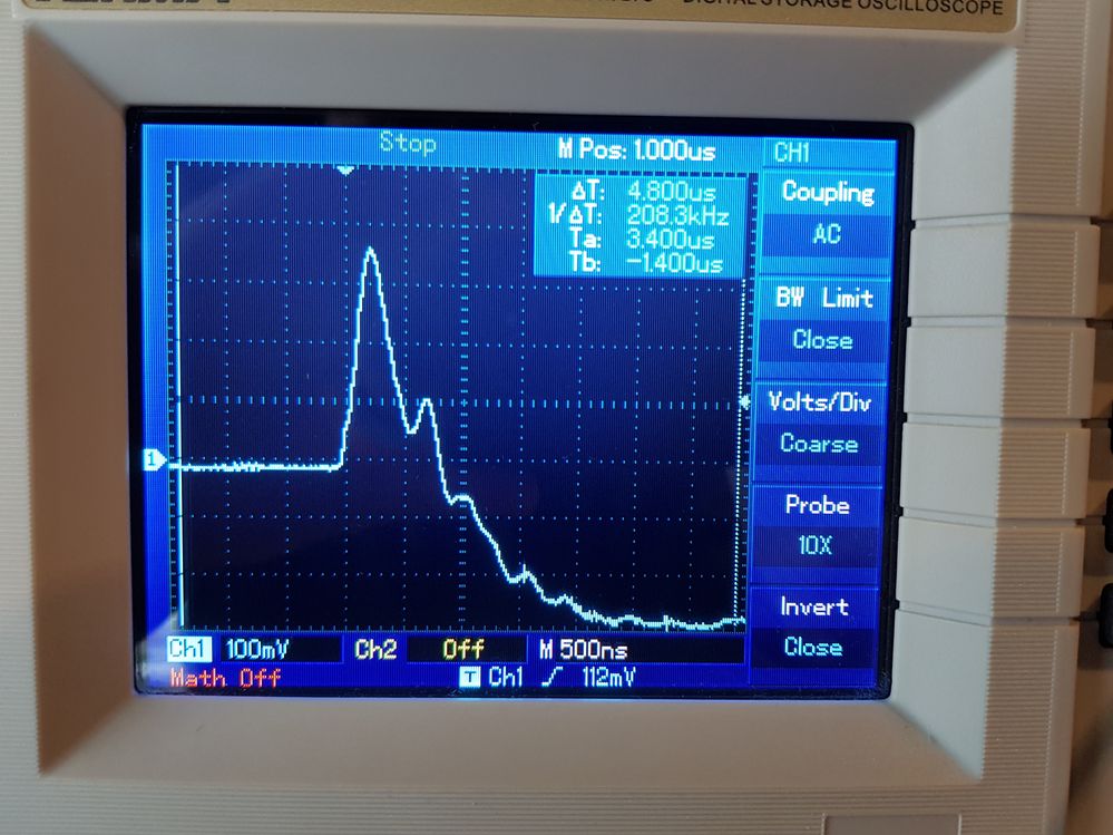

0693W00000FDkomQAD.jpgThis picture shows the voltage change on the PC13 pin which is configured as output pin, when PB14 pass from low to high.

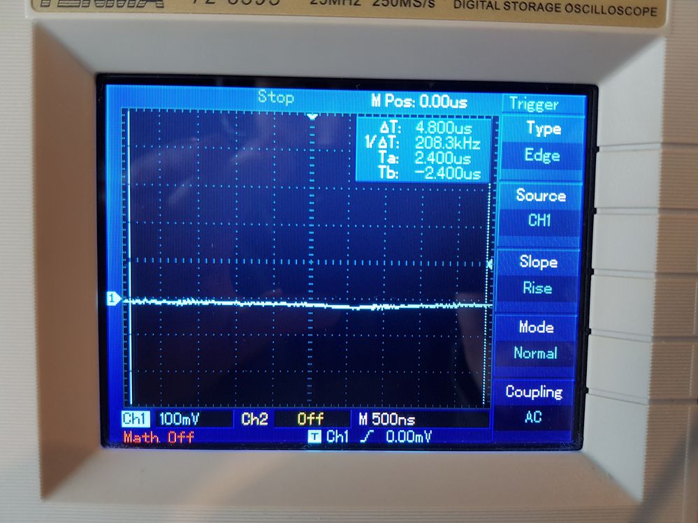

0693W00000FDknoQAD.jpgAnd picture shows the voltage change on the PC13 pin which is configured as output pin, when PB13 pass from low to high.
0693W00000FDkrqQAD.jpgThis picture shows how PC13 (LED-MCU) is connected.
In addition, fluctuation on PB14 is bigger than the others.
As I mentioned before, PC4, PC5, PB13, and PB14 pins have same circuit structures and same configurations. But this fluctuation on voltage problem occurs only PB13 pin when goes Low to High.
