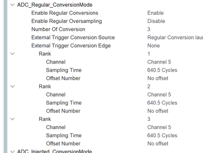

This IOC configuration doesn't match the code you posted. Here is the ADC2 configuration. Note that 3 channels are being converted, not 1.
Nor does it produce the code you posted.
The handle it generates is called hadc2, not ADC2Handle.
I don't think you're looking at the code it's generating.

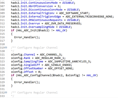

Okay, I've done some more digging.
First, I read the contents of a bunch of ADC2 registers right after initialisation in main.c (the auto-generated code):
static void MX_ADC2_Init(void)
  /* USER CODE BEGIN ADC2_Init 0 */
  /* USER CODE END ADC2_Init 0 */
  ADC_ChannelConfTypeDef sConfig = {0};
  /* USER CODE BEGIN ADC2_Init 1 */
  /* USER CODE END ADC2_Init 1 */
  /** Common config
  hadc2.Instance = ADC2;
  hadc2.Init.ClockPrescaler = ADC_CLOCK_ASYNC_DIV1;
  hadc2.Init.Resolution = ADC_RESOLUTION_12B;
  hadc2.Init.DataAlign = ADC_DATAALIGN_RIGHT;
  hadc2.Init.ScanConvMode = ADC_SCAN_ENABLE;
  hadc2.Init.EOCSelection = ADC_EOC_SINGLE_CONV;
  hadc2.Init.LowPowerAutoWait = DISABLE;
  hadc2.Init.ContinuousConvMode = DISABLE;
  hadc2.Init.NbrOfConversion = 3;
  hadc2.Init.DiscontinuousConvMode = DISABLE;
  hadc2.Init.ExternalTrigConv = ADC_SOFTWARE_START;
  hadc2.Init.ExternalTrigConvEdge = ADC_EXTERNALTRIGCONVEDGE_NONE;
  hadc2.Init.DMAContinuousRequests = DISABLE;
  hadc2.Init.Overrun = ADC_OVR_DATA_PRESERVED;
  hadc2.Init.OversamplingMode = DISABLE;
  if (HAL_ADC_Init(&hadc2) != HAL_OK)
    Error_Handler();
  /** Configure Regular Channel
  sConfig.Channel = ADC_CHANNEL_5;
  sConfig.Rank = ADC_REGULAR_RANK_1;
  sConfig.SamplingTime = ADC_SAMPLETIME_640CYCLES_5;
  sConfig.SingleDiff = ADC_SINGLE_ENDED;
  sConfig.OffsetNumber = ADC_OFFSET_NONE;
  sConfig.Offset = 0;
  if (HAL_ADC_ConfigChannel(&hadc2, &sConfig) != HAL_OK)
    Error_Handler();
  sConfig.Channel = ADC_CHANNEL_6;
  sConfig.Rank = ADC_REGULAR_RANK_2;
    Error_Handler();
  sConfig.Channel = ADC_CHANNEL_7;
  sConfig.Rank = ADC_REGULAR_RANK_3;
    Error_Handler();
  /* USER CODE BEGIN ADC2_Init 2 */
  slDebug[0] = ADC2->CR;
  slDebug[1] = ADC2->CFGR;
  slDebug[2] = ADC2->CFGR2;
  slDebug[3] = ADC2->SMPR1;
  slDebug[4] = ADC2->SMPR2;
  slDebug[5] = ADC2->SQR1;
  slDebug[6] = ADC2->SQR2;
  slDebug[7] = ADC2->SQR3;
  slDebug[8] = ADC2->SQR4;
  slDebug[14] = (uintptr_t)&hadc2;
  /* USER CODE END ADC2_Init 2 */
In addition, I also read the address of hadc2, just to make sure that it matches my pointer in adc.c.
