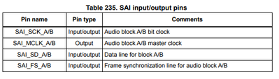

I want to connect the STM32L433VCT6 to the ML22530TB (ROHM) using SAI communication.
Where should I connect the ML22530TB's LRCLK, BCLK, SAI_IN, and SAI_OUT pins on the STM32L433VCT?

I advise you to refer to reference manual "Table 235. SAI input/output pins" for pin descriptions.
I hope this help you.

Just set the SAI in Cube and the mode you want.
You see the pins and pin functions then.
