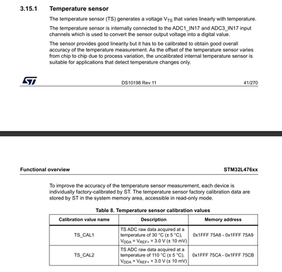

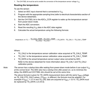

How are you calculating the Temperature from the ADC Data Register ?.
Have you calibrated the Internal Temperature Sensor according to the Reference Manual. ?
danielbathtub
Are you following the procedure above ?

Thanks and yes I'm aware of the procedure and went over this several times. My implementation relies on the STM32 HAL.
The point is not about the conversion and calibration (by the way, after conversion I'm seeing temperature around 20-23C at ambiant so no issue there) but realy about the temperature sensor voltage that increase until 2100mV or so when I heat the sensor (which is expected) but then switch ti 690-700 when I continue to heat the sensor.

The problem with HAL is that you don't know what they do in their predefined functions. To do proper Firmware development you need to check the registers and verify everything is correct as I already previously pointed out. I also have a few questions for you due to the lack of detail you presented your issues with here.
How do you know that you are using the Temperature channel ADC conversion to calculate the Temperature ?.
How do you know that the temperature you are heating the chip to is below 150 degrees Celsius ? Maximum operating temperature of the MCU ?.
-"The point is not about the conversion and calibration (by the way, after conversion I'm seeing temperature around 20-23C at ambiant so no issue there) "
Have you actually measured the ambient temperature to back the assumption you've made ?. Does your method of calculating temperature in your firmware give the correct results for 10C or 50C or 90C?.
If you haven't verified the above, then your assumption is wrong. Then you can't assume you did things correctly.
How do you know that you're sampling the Temperature Sensor/Internal Channel Slow Enough, have researched these parameters in the Datasheet ?.
