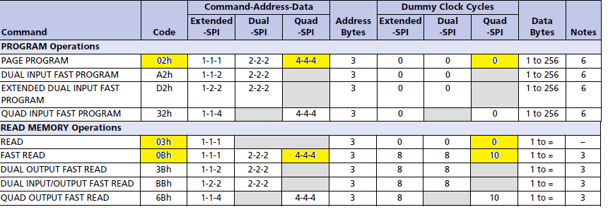

I still think your number of lines for address/ data or dummy cycles are not correct. Also its not easy to help since you are not using the formatting tools provided in this forums as well as pasting the whole code for no reason. Leave only the needed functions of interest and format them using the code block.
John3
Ok thanks. I have checked all address, data and dummy cycles but didn't find anything wrong. Below I am sharing MT25ql128 data sheet command details and code I am using to write and read from serial flash. I have tried both READ & FAST READ command and dummy cycles as 0 and 10 respectively but in both cases getting 0x88 data.

Could you please help to check, am I doing anything wrong in terms of address, data and dummy cycles.
Thanks,
John

John3
Hi Luka,
I have fixed the write and read data from mt25ql memory. I am able to write and read data from mt25ql memory.
Currently I am operating with the memory manually, mean to say beginning the address of memory from 0x00000000. I want to change the starting address from 0x90000000, as i know I need to change operating mode in XIP mode during power on time.
What are the other things need to be take care when I operate in XIP mode.
Thanks,
John
