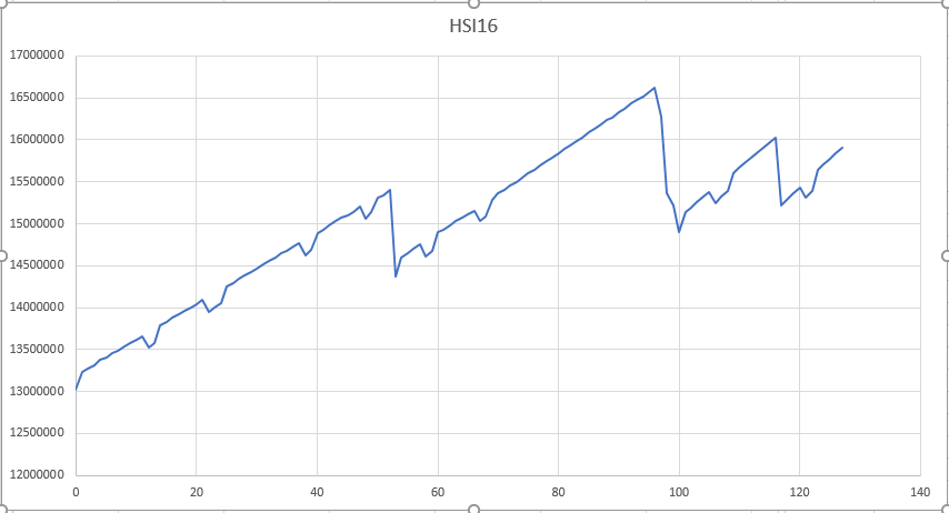

On our project 4 (out of 1200) devices startet to have problems after a few weeks of working. It turned out they had a HSI16 of 15MHz @ the default calibration settings. A recalibrating brought it back to 16MHz, but questions arises:
  1. How can the HSI16 come out of frequency in a very stable environment ?
  2. Do we need to check and recalibrate the HSI16 (MSI) in a timed base manner?
MCU: STM32L496QGI6P
Thanks for any comments
Armin
Sounds like the possible calibration extreme.
Wasn't the calibration register overwritten by 0 (possibly due to software bug)?
aritec
It was reproducable with every restart.
Here you see the relation HSI16 frequency to calibration value (0..127).
The measurement was done with the LSE 32768Hz 100ppm mean of 10x LSE trigger divided by 8.
