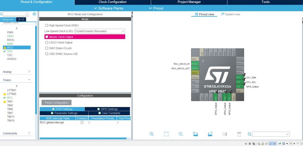

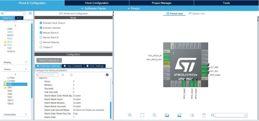

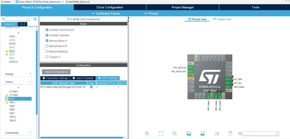

Hi all,
I am using STM32L431 and the device is not waking up from STOP mode with an RTC alarm interrupt. Can somebody pinpoint where my issues are?
My configurations in the code configurator:
0693W00000AOx6zQAD.jpg0693W00000AOx7JQAT.jpg0693W00000AOx7nQAD.jpgI am enabling the crystal oscillator, enabling the calendar, alarm, and the interrupt through EXTI18, the only parameter I change is the time of the alarm set to 5 seconds.
