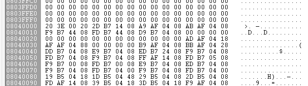

Here's what I currently do:
- Flash a new, blank MCU and boot from bank 1.
- BOOT0 is externally pulled LOW. BOOT1 is being used otherwise.
- Load firmware starting at address 0x08040000 (start of bank 2)
- Flip the nBFB2 bit in the Options register. No other changes are made in other config registers
Now I expect the device to boot from bank 2 but nothing happens. Any idea why this may be?
Please see image of a read of the MCU after loading firmware into Bank 2:
Thanks!

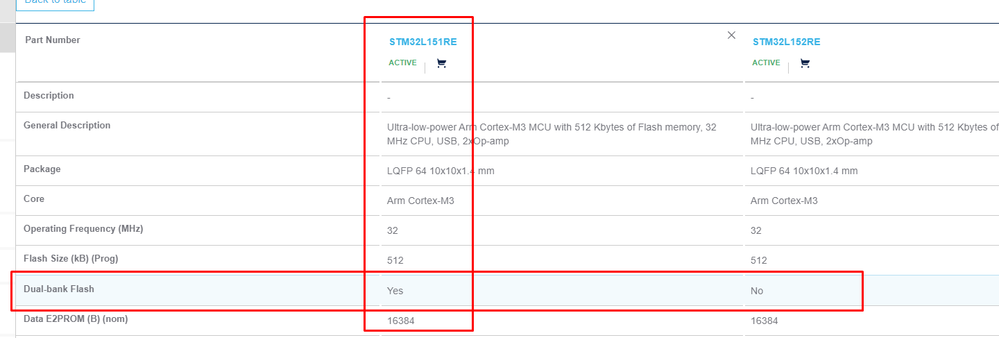

nothing seems to work as expected, but i think the bit nBFB2 should have some affect, if not, how would you build a firmware that needs more then 256k of flash, because above that size some data will be writen on address 0x8040 0000... so the internal bootloader cant just use this address to validate the firmware in bank2.
i am wating some answers from st team, but to me, it just dont work and they dont know yet or dont want to confirm that...
by the way, there is some missleading information about wich one have or not the dual bank mode, in datasheet it says that MCU cat 4/5/6 have dual bank, but in the product selector only the STM32L151RE has it... i tested the with both 151 and 152, none of then worked.
