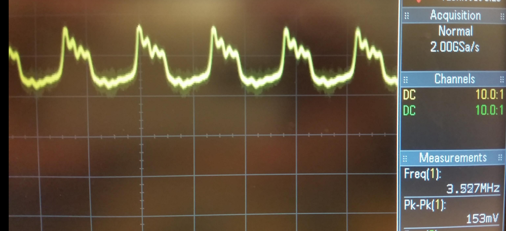

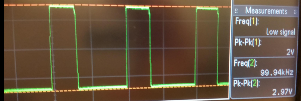

When I run my board with this code I find that the TIM4 correctly ouputs a 100KHz square wave with a peak to peak voltage of 3V. The TIM11 channel outputs an unclean square wave with a very low peak to peak voltage and only approx. a 3.5MHz signal. If I try to reduce the prescaler value to 1 in order to increase the frequency further, I lose the waveform completely. The results from the oscilliscope are show below:
TIM4 -
TIM11 -
Any help on getting the TIM11 pwm to be a clean square at 5MHz with 3V peak to peak would be greatly appreciated.
