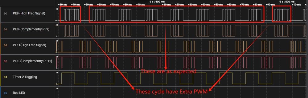

I am trying to generate sinewave using PWM mode of microcontroller.
I am using Discovery Board having STM32F407 microcontroller. System clock and Timer clock are of 8Mhz
I am using two timers
Timer1 for High Frequency switching (500Hz) and Timer2 for Low Frequency switching (50Hz).
waveforms I am getting are OK but there is one issue, after every 7 cycles I am getting an extra PWM sample in my output.
I don't know why it is so. I am attaching image of the output and code. may be there is a minor mistake which I am doing but not sure. can you guys let me know if there is an issue

waclawek.jan
Maybe you want to toggle currentHalfCycle based on counting sineIndex (as you already do for resetting every 5 samples), and avoid using TIM2 altogether.

AHayee
I didn't get your point @waclawek.jan
My concern is why after every 7 cycles this happens. The response between these cycles is perfect.
because of this what happens is 7 cycles of 50Hz are generated and then suddenly 8th cycle generate 45Hz and then again normalize, after 7 cycle again 1 cycle of 45Hz and this loop continuous.

waclawek.jan
> My concern is why
Let me guess: you have used 80 as TIM2 prescaler instead of 80-1, and similarly the ARR values are not N-1.
The consequence is, that the frequency ratio is not 1:10 (and the absolute frequency is not 50Hz/500Hz, as witnessed e.g. by the 50Hz signal at your picture slowly changing its edges' distance from the 10ms markers).
Even with the correct exact 1:10 frequency ratio you can still have some unexpected effects from the interrupt handling ordering, given interrupt priorities and the exact phase difference between the two timers, and the code including Cube/HAL's internals. That's why my recommendation above.
@waclawek.jan I tried what you recommend, not using the Timer2 and changed the Timer1 routine according to the index. It is working now. I will run this continuously and see if any issue occurs and also change the sineTable values to see the response and get back here.
