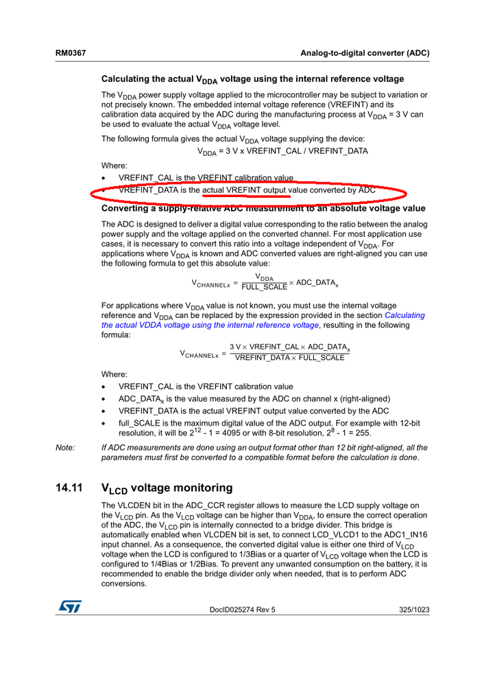

RM0376 Reference manual for STM32L0x2 DocID025941 Rev 5 states in 14.9 "Temperature sensor and internal reference voltage" :
The following formula gives the actual VDDA voltage supplying the device:
VDDA = 3 V x VREFINT_CAL / VREFINT_DATA
This can't be right! If VDDA is greater than 3V then VREFINT_DATA > VREFINT_CAL, but the formula above will yield an actual voltage < 3V. The correct formula must be
VDDA = 3 V x VREFINT_DATA / VREFINT_CAL
How on earth has this been able to passed the documetation review???
VREFINT_DATA is the readout the ADC takes from the internal VREF source. Let's assume that's internal source is 1V (it is not, but let's assume that for sake of simlpicity). If VDDA=VREF+ = 3V, ADC readout will be one third of the full range (which is 4095 for 12-bit ADC), i.e. around 1365. That's what has been measured by the manufacturer and stored in the system memory as VREFINT_CAL.
Now let's increase VDDA=VREF+ to 4V (again it can't be done in reality, but for the simplicity let's assume that it can be). The readout for 1V internal source is now one fourth of the full range, i.e. around 1024 - so for increased VDDA, VREFINT_DATA < VREFINT_CAL.
Maybe you might want read my writeup on this topic.

No, VREFINT_DATA is not the readout from the internal VREF source. It's the A/D conversion of the external Vdda pin on the processor. VREFINT_CAL is the factory stored ADC value of the internal precise voltage reference of 3V. It just makes no sense in multiplying 3V with the corresponding ADC value as is done in the reference manual.
It's like saying that if I'm driving at 90km/h and the engine is running at 3000rpm then the speed from the rpm should be
speed = 90 * 3000 / rpm
Because that would mean that if engine was running at 6000rpm then car would go 45km/h. And I can just conclude that if I follow the reference manual and try to establish the Vdda voltage then I get a completely incorrect value, whereas the corrected formula produces what I can measure with a DVM on the pin.
waclawek.jan
My RM says otherwise:
But I understand your confusion. The RM should be clearer in stating, that that formula is to be used when VREF+ is tied to VDDA, and their voltage is not known (the intended usage of this is in direct-battery-powered appliances).
