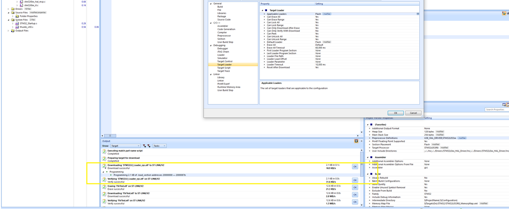

Hi, I would like to know how to flash a program to my STM32L053 Nucleo board, for now after each power cycle I need to download the program via a debugger to the board, is how do I flash the program to the board ?

Your tools should be flashing the firmware, it would be quite difficult to create a project that didn't, so more likely something in your process is wrong.
Did you set any option bytes?
How do you know your code isn't running?
Are you linking for operation at 0x08000000 ?
Try one of the examples in CubeMX for your board.​

it is targeting the ram which is 0x200000000 ++

I am using cubeMX to generate this program
Try examples in CubeL0, for instance one that blink LED/GPIO
Pick FLASH as the target​
How do you pick FLASH as the target ?
Hi, i manage to load it to the flash i think, however the reset button wont work when i use build and run. even I have set the STARTUP_FROM_RESET.
below is the download log:
xecuting match part name script
Loading target script file STM32_Target.js
Executing script MatchPartName("STM32L053R8")
Preparing target for download
Executing script FLASHReset()
Downloading ‘STM32L0_Loader_rpc.elf’ to ST-LINK/V2
Programming
Programming 2.1 KB of .load_section addresses 20000000 — 2000087b
Programming completed in 64 ms — 33,937 bytes/sec
Download successful
Verifying ‘STM32L0_Loader_rpc.elf’ on ST-LINK/V2
Verifying
Verifying 2.1 KB of .load_section addresses 20000000 — 2000087b
Verifying completed in 45 ms — 48,266 bytes/sec
Verify successful
Erasing ‘FlirTest.elf’ on ST-LINK/V2
Erasing
Erasing 12.6 KB of addresses 08000000 — 080032bc
Erasing 0.0 KB of addresses 080032c0 — 080032c3
Erasing completed in 592 ms — 21,947 bytes/sec
Erase successful
Downloading ‘FlirTest.elf’ to ST-LINK/V2
Programming
Programming 12.6 KB of addresses 08000000 — 080032bc
Programming 0.0 KB of addresses 080032c0 — 080032c3
Programming completed in 7 ms — 1,856,142 bytes/sec
Download successful
Verifying ‘FlirTest.elf’ on ST-LINK/V2
Verifying
Verifying 12.6 KB of addresses 08000000 — 080032bc
Verifying 0.0 KB of addresses 080032c0 — 080032c3
Verifying completed in 9 ms — 1,443,666 bytes/sec
Verify successful
Preparing target for user application
