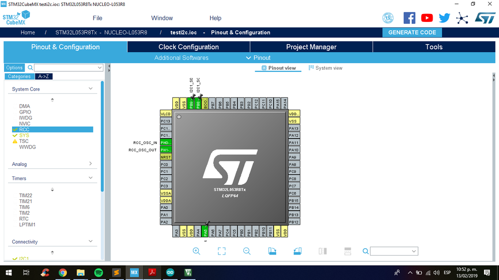

I'm trying to recover the data from the LIS3DH sensor and I found this tutorial " https://www.youtube.com/watch?v=A1CIOUZdeR4". In the tutorial the person uses function " if(HAL_I2C_IsDeviceReady(&hi2c1,SLAVEI2C_ADD,10,100)==HAL_OK) " to see if the sensor is ready for use. However when I make the connections and run the program, I don'tsee anything, I do not know if you can give me some advice.
I connected the sensor as follows:
Sensor STM32
SDA -> SDA/D14
SCL -> SCL/D15
SDO -> 3.3v
GND -> GND
Vcc -> 3.3v
#include "main.h"
I2C_HandleTypeDef hi2c1;
#define SLAVEI2C_ADD 0x19
static void MX_I2C1_Init(void);
int main(void)
HAL_Init();
SystemClock_Config();
MX_GPIO_Init();
MX_I2C1_Init();
HAL_Delay(1000);
HAL_GPIO_TogglePin(GPIOA,GPIO_PIN_5);
while (1)
}I want to recover the aceleration but i can't do a simple step..... Someone could help me???
