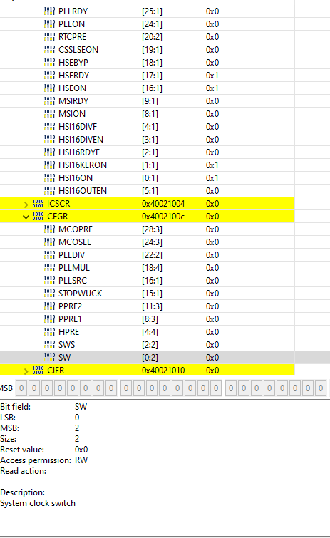

i have the strange behavior that the Clockswitch to HSE does not work in STM32L051.
    __HAL_RCC_SYSCLK_CONFIG(RCC_ClkInitStruct->SYSCLKSource);
    /* Get Start Tick */
    tickstart = HAL_GetTick();
    if(RCC_ClkInitStruct->SYSCLKSource == RCC_SYSCLKSOURCE_HSE)
      while (__HAL_RCC_GET_SYSCLK_SOURCE() != RCC_SYSCLKSOURCE_STATUS_HSE)
        if((HAL_GetTick() - tickstart ) > CLOCKSWITCH_TIMEOUT_VALUE)
          return HAL_TIMEOUT;
I always hit the Timeout value due to RCC->CFGR->SW will never be set to "8".
"8" means External Highspeed Oscillator.
A check of the SFRs shows me that RCC->CFGR->SW has a width of 2Bits but i need at least the 3 Bits for value "8".
RCC->CR-> HSERDY and HSEON shows "1" as expected and is measure 8 MHz Oscillator Frequency switched On. 0693W00000KamC7QAJ.png

Failure found, was a Misstypo in SCM -> wrong µC in project.

Additional Information: Understood the bitmasking for Value "8" and
Code Line
__HAL_RCC_GET_SYSCLK_SOURCE() ((uint32_t)(READ_BIT(RCC->CFGR,RCC_CFGR_SWS)))
We check HW and come back again
