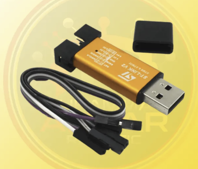

This is both circuit diagram and ST Link i used. For ST link i try with the board i bought (STM32F401C) is working fine but it not working with STM32L011. Can you help me? Also if you need more information please let me know. Thank you so much
Yes, so that's a boot-leg ST-LINK, using ST-LINK Utilities, or newer STM32 Cube Programmer?

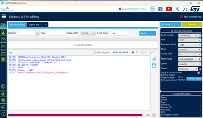

Does the Cube Programmer report the correct target voltage?
Esa1
No. It said, it voltage is 3.29V

Sorry that i can't provide you with testing image because i don't have a board with me now. but tomorrow. I will send you all testing picture. Also i confirm by read direct on NRST pin is 3.3V, for BOOT0 pin i also try to pull them to low. But seem nothing work. I even try to replace the STM32 chip but still the same result. :(

This is the image of CubeProgrammer. I try put pin NRST to low while trying to connect. It seem can detect that the chip is in RST state.
