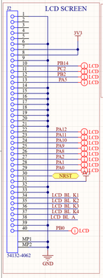

I'm working on a custom STM32H7S7L8 board with this display
https://newhavendisplay.com/fr/2-4-tft-lcd-ips-high-brightness-display/
Here the schematic of the connection in 8 bit mode and clock three

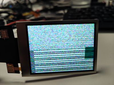

The backlight and display are working but I get a glitch image when i try to fill the display.
with this code i can see the display turning off and on so the command are working
Below the whole project zip
	  LCD_Fill(0xFFFF, 0, 0, 10, 10);

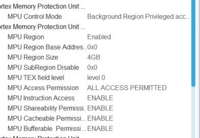

Did you modify this line in MPU config or it was generated by CubeMx:
  MPU_InitStruct.SubRegionDisable = 0x0;
 Normally it should be 0x87 not 0x0!
mƎALLEm
Also these lines?:
  MPU_InitStruct.AccessPermission = MPU_REGION_FULL_ACCESS;
  MPU_InitStruct.DisableExec = MPU_INSTRUCTION_ACCESS_ENABLE;

It was generated by cube MX to test if the issue was MPU usage but even without the MPU it doesn't work
Did you change the default MPU config in CubeMx?
Hamady
Yeah i made the test without MPU and after enabled MPU that give permsission to the whole chip
You should not modify that MPU region, keep it as is.
You need to add another MPU config for the LCD region and you should disable the cacheability for that region. You need also to enable the cache.

I'm not telling that I'm giving a solution to your original problem but the MPU config you set is not recommended as you are opening all the access and the instruction execution and the cachability to all the 4G mapping that induce to many issues:
  MPU_InitStruct.BaseAddress = 0x0;
  MPU_InitStruct.Size = MPU_REGION_SIZE_4GB;
So what I suggest is to keep the default MPU region 0 as is (like proposed by CubeMx at first time) and add another region dedicated for the LCD. This is the default MPU config. Only region 0 is configured:
