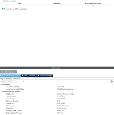

Hello everyone,
I'm working on STM32H7S7L8 custom board with same architecture as the DK board ( for XSPIM)
The mcu and flash is working fine i can uplaud a boot/appli without issue (touch gfx + lwip work so the hardware is fine)
But working on the FW 1.3.0 I'm unable to make MCE work.
I followed step by step the MCE workshop : https://github.com/ST-TOMAS-Workshop/stm32h7s_workshop/blob/main/3_external_memory_encryption/external_memory_encryption.md
But when I build the extmem loader and try to uplaud the code I got :
Weird thing is that i already made MCE work on the DK board without issues but here it is not possible

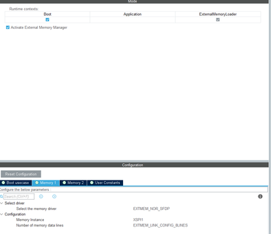

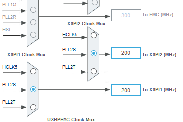

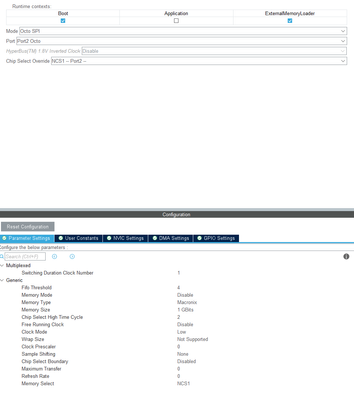

Here the Cube MX settings that i used to make it (SBS also enabled in cube programmer / Cube MX ) and 192kb of DTCM setup
Do you have an Idea to make it work.
Thanks

Imen.D
Hello @Hamady
Perform a full chip erase, also make sure that your board has stable power supply.
Thanks
Imen
Hamady
Senior
Hi @Imen.D
The board has a good power supply since i can uplaud a code to the flash without MCE
Thanks
Hamady
Senior
Hi @Imen.D
I tested the code on discovery board so hardware is fine.
It really seems that the new firmware pakage create a isssue with MCE . i created a new proejct and the EXTMEM Loader works only without MCE.
Here my project
Thanks
