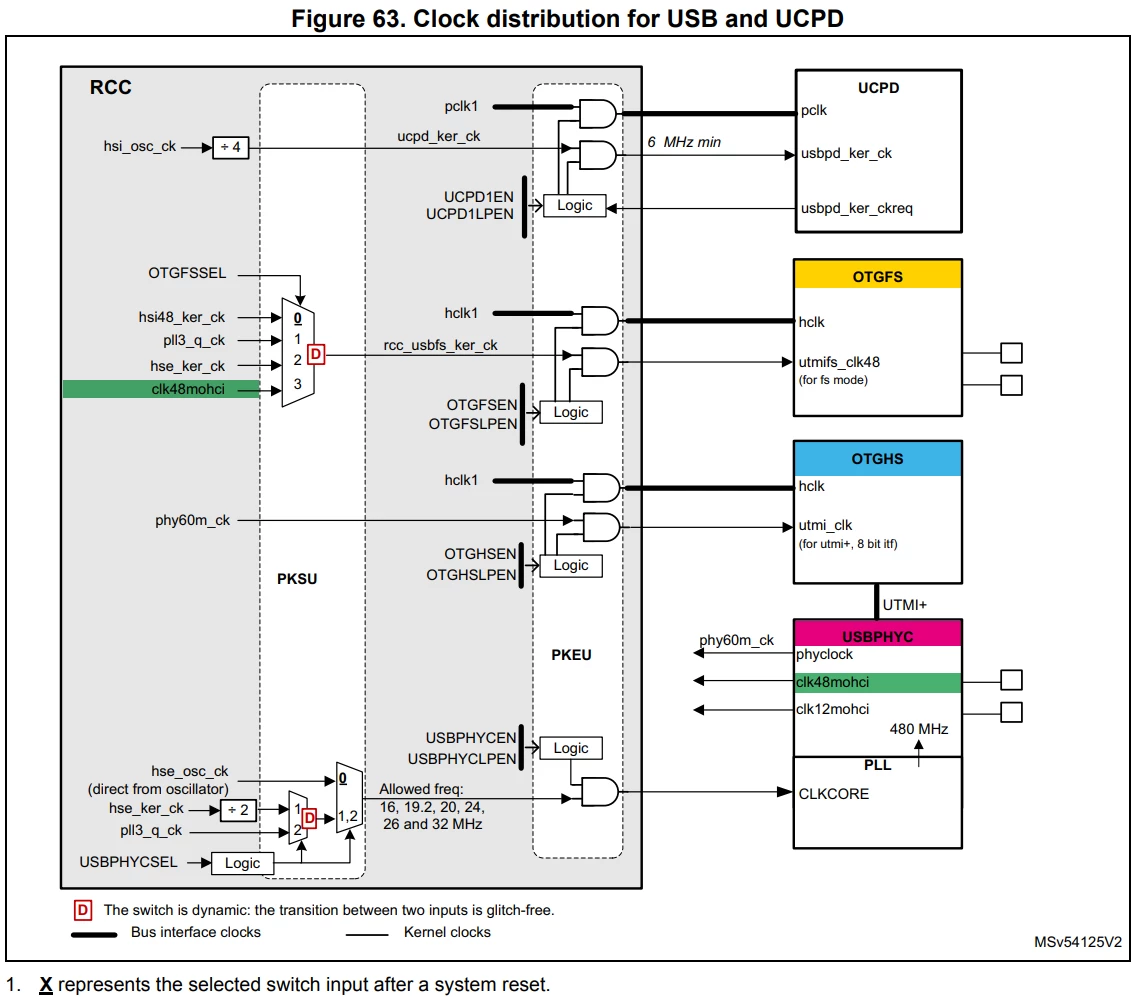

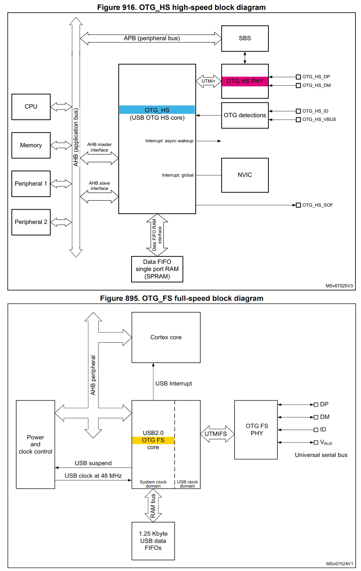

2.2 STM32H7RS use case
Here is an overview of USB HS controller and USB FS controller extracted from RM0477.
OTG_HS PHY (also called USBPHYC) does not intervene when using FS controller unless selecting its clock source. The following diagram gives an overview of the clock distribution of USB controllers in STM32H7RS.
The STM32H7RS series has a more complex clock distribution for USB controllers. The USBPHYC block is intended for the OTG_HS controller.
If using clk48mohci (from USBPHYC), ensure the USB HS regulator is enabled:
HAL_PWREx_EnableUSBHSRegulator();
Alternatively, change the clock source for OTG_FS to one of the following:
  • The hsi48_ker_ck for crystal-less applications
  • hse_ker_ck
  • pll3_q_ck
