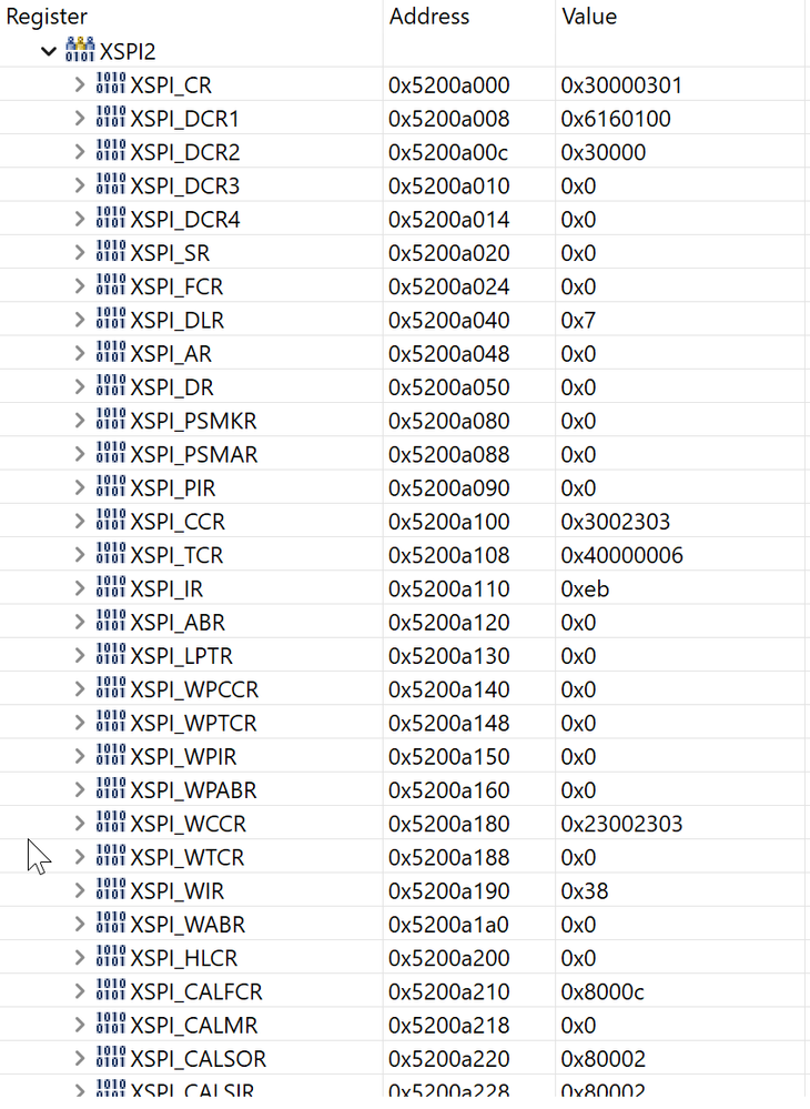

When system startup, the SW can properly initializes the PSRAM with reset, toggle-burst-boundary(chip specific feature), readID and enabled to memory-mapped mode successfully. Below image shows the registers after init:
According to Errata: 2.4.1 Memory-mapped write error response when DQS output is disable
Description: If the DQSE control bit of the XSPI_WCCR register is cleared for memories without DQS pin, it results in an error response for every memory-mapped write request.
Workaround: When doing memory-mapped writes, set the DQSE bit of the XSPI_WCCR register, even for memories that have no DQS pin.
So I did  "commandBase.DQSMode = HAL_XSPI_DQS_ENABLE" for memory-mapped write instruction.

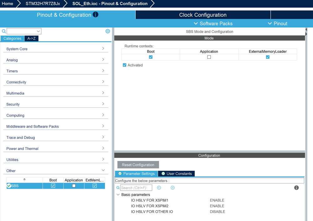

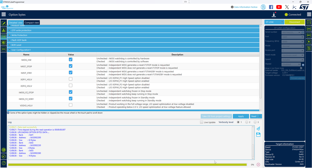

Hi Kaouthar, Thanks for your reply!
For HSLV, I checked the high-speed-option are disabled on both XSPI 1 and 2. See:
But the HSLV are enabled from MX->SBS. Shall I disable it too?
We will check the I/O/compensation from errata 2.2.15, and get back later.

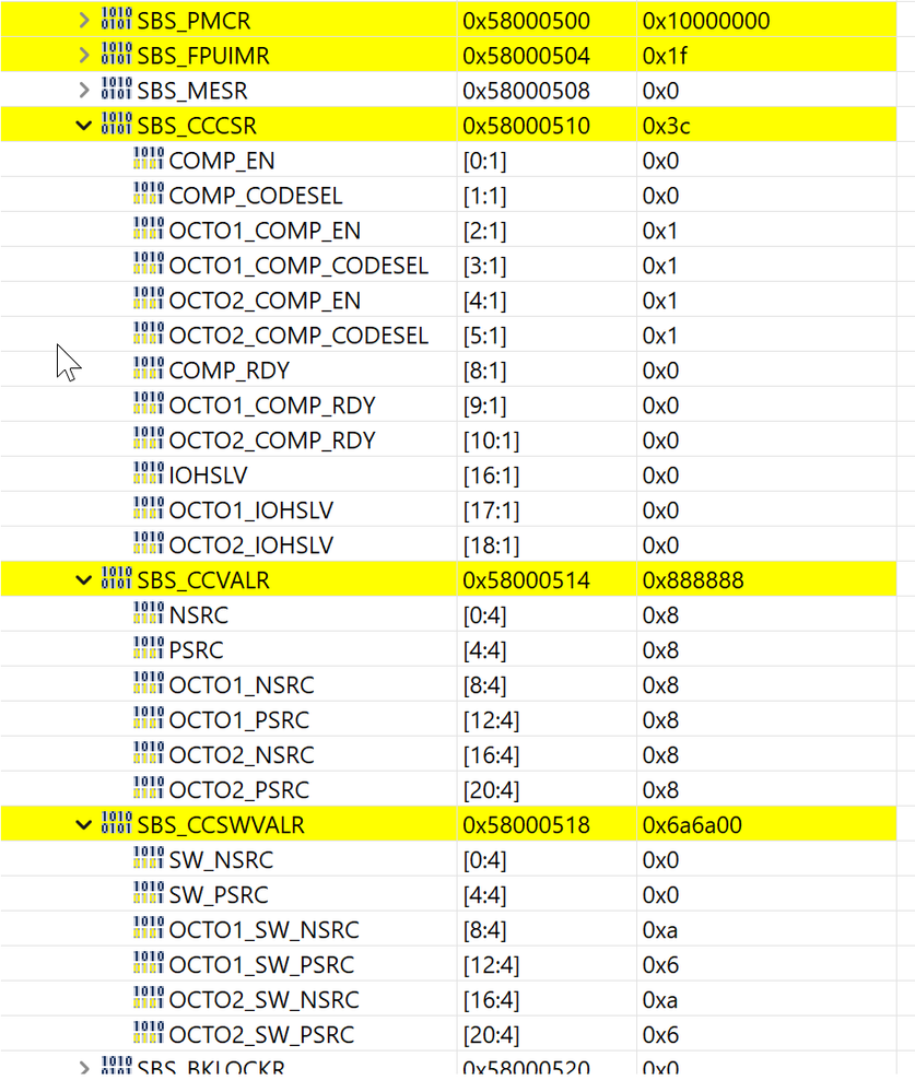

Hi @KDJEM.1,
I did test according to errata 2.2.15. See below:
1) The error rate is significantly reduced by disabling automatic I/O compensation on XSPI pins (SW compensation is not applied), and slowdown the speed:
XSPI-2 Clock (MHz)Total BytesError BytesError Rate
1338MiB525740 ~ 6856298.57%
66.58MiB800 ~ 1000120 PPM
33.258MiB172 PPM
2) Then apply SW I/O compensation on XSPI (Follow workaround from Errata 2.2.15)
The value of flash memory at address 0x08FFF840 @3.3 V is 0xFFFFFFFF. So we go with case-1: The calibration value from register SBS_CCVALR is 8. The result shows the SW compensation does not help in high speed, and a little bad with low speed:
1338MiB527700 ~ 6856948.57%
66.58MiB800 ~ 1191200 PPM
33.258MiB13 ~ 304 PPM
Double check the SBS registers:
Summary:
  • The DQSE bit of the XSPI_WCCR register is set for doing memory-mapped writes.
  • Both XSPI1_HSLV and XSPI2_HSLV are disabled.
  • Automatic I/O compensation is disabled in XSPI1 and XSPI2, with or without SW compensation applied.
All these can't fix the unstable problem. Any suggest?

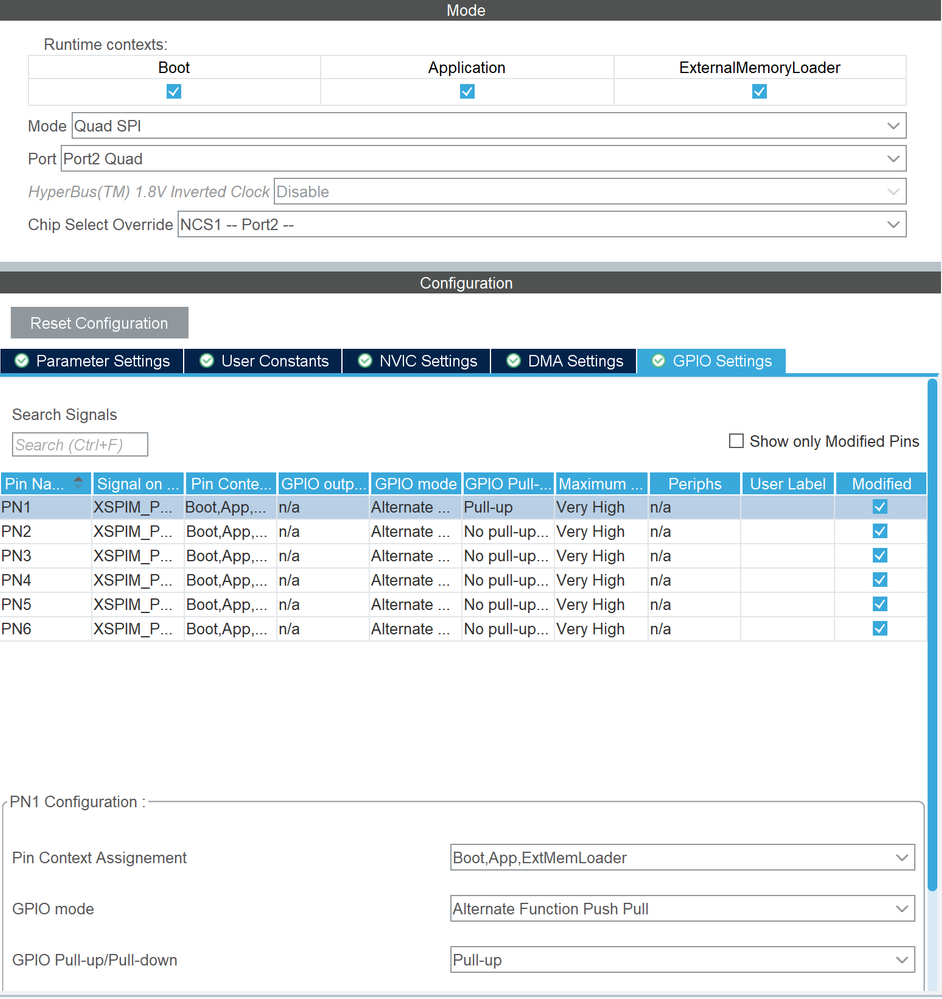

Hi @KDJEM.1
The VDD for MCU and PSRAM is 3.3v. It is confirmed that I/O HSLV is not set on my board.
To avoid the damage case, I checked the HSLV and do all tests on 3 boards. Get same result.
I did not check the pin-mux settings since this is generated by MX.
Thanks!
Leo Ruan
