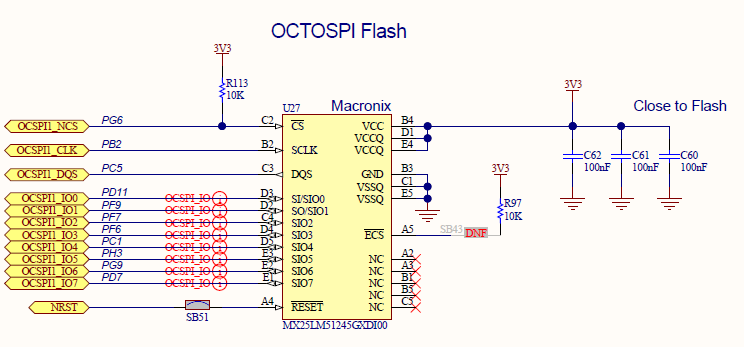

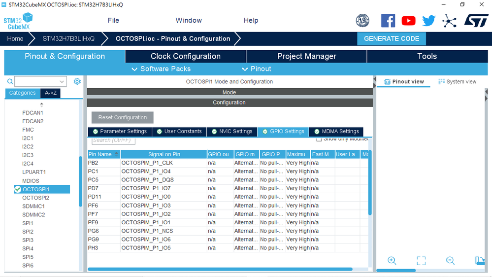

I connected the pin according to stm32H7B3I_Schematic.pdf, and I have repeatedly confirmed that the pin is correct, so it should be correct...
The picture below is the pin of stm32cube and STM32H7B3 OctoSPI Flash Schematic pdf.
Does it work in non-DTR mode?
Bring up the OCTOSPI part in the simplest of modes and get that working.
I haven't read the Macronix spec cover to cover, but I'd doubt the status register is using complex modes, and certainly not out of reset.

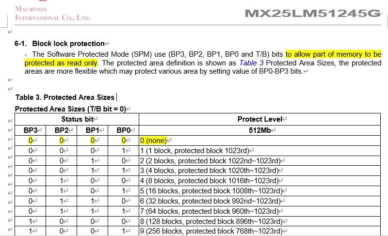

4. Since I am a newcomer and have only recently started learning, I am guessing whether the issue could be related to Block lock protection?

The block lock is more likely to result in Erase or Writes failing. Doing a Write Enable typically doesn't infer an address.
