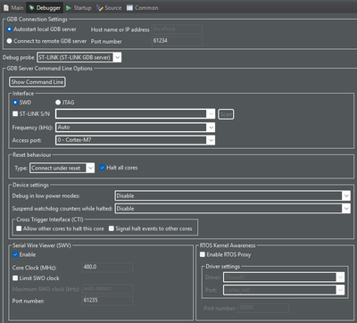

Here is my situation :
I'm debugging a STM32H757XIH6 using STM32CubeIDE v1.18.1
I'm trying to get SWO from CM7, by enabling SWV in the CM7 Debug configuration as on following picture. Note that the SWV is disabled for CM4 Debug configuration
I've got a simple code that works well for SWV and I can see my printf in the SWV ITM view. So my hardware is good, and the IDE is able to display the printf.
But my main project got the error message that @CWadd provided...

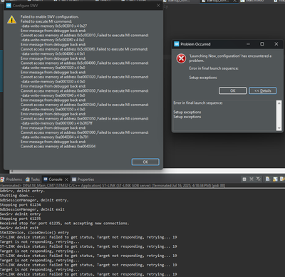

This doesn't happen at the first debug session. The first session works, but doesn't output anything in SWV ITM View. Then I'm unable to debug again and got the error message.
In this situation I cannot debug anymore, and always get this message, even with the simple program. So I need to erase all flash with CubeProgrammer, and I can debug again.
I've compared everything between these 2 codes and didn't find anything to solve my problem.
I'm thinking about a write protection on the SWO config registers (which are designated by first addresses in the error message). But I didn't know where to look, and what I can do about that.
Have you got any clues or intuition about something I should check ?

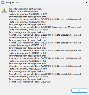

I have the same issue, I have try to :
* change cables and PC port
* change my PC (Mac and Windows) (STM32CubeIDE 1.18.0)
* set script to set sw register, in Debug Configurations > startup > Run commands
* set by my self swo pin (see below)
* do my own swo_init function called in main after GPIO init (see below)
Has anyone found a solution?

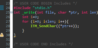

I had same problem my fix was. once you paste that at top everything will work
#include "stdio.h"
int _write(int file, char *ptr, int len){
int i=0;
for (i=0; i<len; i++){
ITM_SendChar((*ptr++));
Senior

 AN4989 looks similar to application notes
the stuff code i gave fixed it allowing me to use printf there might be something else that causing that error for you. try using printf to see if you even getting output. Just printf

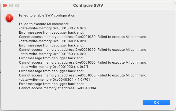

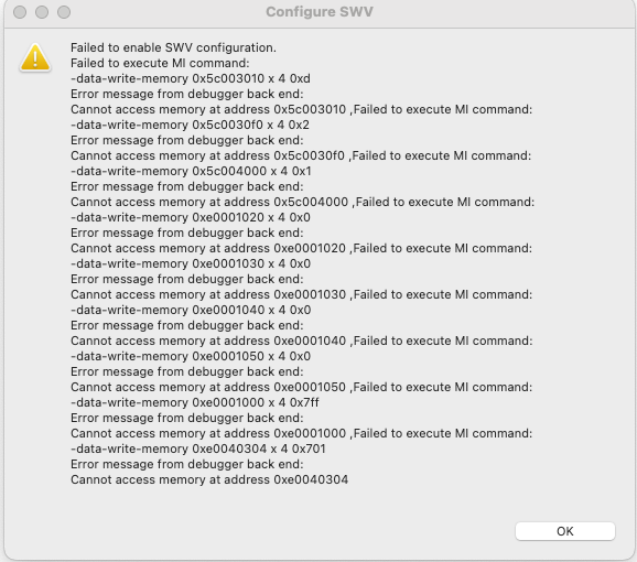

Hi @lsag-lucast, I have the same problem. Have you managed to solve it?
@Imen.D is this problem being checked at ST?
I attach the screenshot of the errors:
