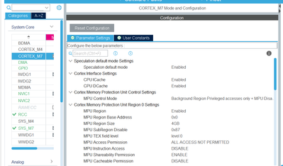

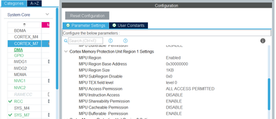

1. MPU configuration in STM32Cube IDE.(Region 0 default configuration to prevent the speculative , Region 1 telling cache should not be used to have coherence between ethernet and core)

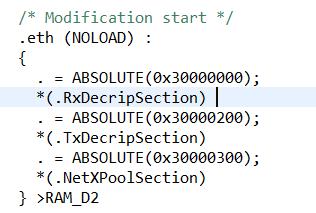

2. Linker script update.(To update DMA descriptors at proper memory location)

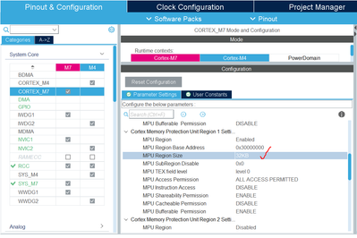

In order fix the hardfault issue, you also need to make the following configuration changes compared to above solution.
The hardfault issue is raised because the nx pool buffer and we need this buffer allocated with memory in non-cachable area to store ethernet data, hence we need to make the following changes to reach 100% data transfer and fault free code.
MPU Configuration: (Previously we allotted only 1KB for descriptors now we increased the size to 32KB because 30KB is requested by NetxPool)
Linker Script:
