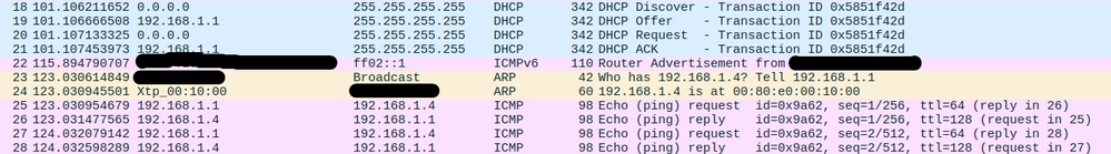

Thanks @STackPointer64 for the support. I added the points you indicated, but the situation hasn't changed.
The application threads are running correctly, but the DHCP process doesn't seem to start.
STackPointer64
After retesting and downloading your project with the suggested adjustments, I can confirm that it works. As shown in the Wireshark screenshot below, the board is discovered by the DHCP server and obtains a valid IP address. I was able to successfully ping the board and receive responses.
As a suggestion, please ensure your DHCP server is functioning correctly. You might also have made other changes in your project. To help, I have attached a copy of the working project—please build and flash it to your MCU, then share your feedback. I’ll be happy to assist further.

GEKO
Thanks again for your support.
I tested the code you submitted and confirm it works.
I checked with my code and I had mistakenly entered the definition
#if defined ( __ICCARM__ ) /* IAR Compiler */
#pragma location = ".NetXPoolSection"
#else /* GNU and AC6 compilers */
__attribute__((section(".NetXPoolSection")))
#endif
under the function
__ALIGN_BEGIN static UCHAR nx_byte_pool_buffer[NX_APP_MEM_POOL_SIZE] __ALIGN_END;
static TX_BYTE_POOL nx_app_byte_pool;
and consequently the buffer was not assigned to the correct section.
