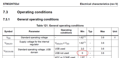

Hope this is a simple question.
I use this device: STM32H753ZIT6
I don't intend to use USB so looked in the datasheet and found the below
Does that mean I can safely connect VDD33USB to GND?
Thank you.

‎2024-04-16 5:27 AM
Correct.
Regards
/Peter

‎2024-04-16 7:03 AM
Great thank you, for a prompt answer.
