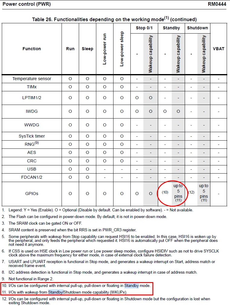

I am using this MCU on a battery-supplied custom board: STM32G0B1RET.
I am looking for clarification re. the GPIO availability in Standby Mode.
Table 26 in Reference Manual RM0444 (see below) seems to offer one of two (exclusive) possibilities:
- Without wakeup capability: wakeup pins are not available, but I/Os can be configured with internal pull-up, pull-down or floating. That would mean a GPIO pin can be assign 0 in Standby Mode.
- With wakeup capability: wakeup pins are available, but GPIOs cannot be configured and are floating.
Please confirm. Thank you!

‎2025-03-14 7:30 AM - edited ‎2025-03-14 7:32 AM
Third option:
All GPIOs can be configured with internal pull-up, pull-down or floating. Out of those pins, 5 (6?) of them have an additional wakeup capability which can be used in addition to the pullups.

‎2025-03-15 2:20 PM
Pull is weak check pdf, typic around >15k. In standby only RTC pins can drive low.
