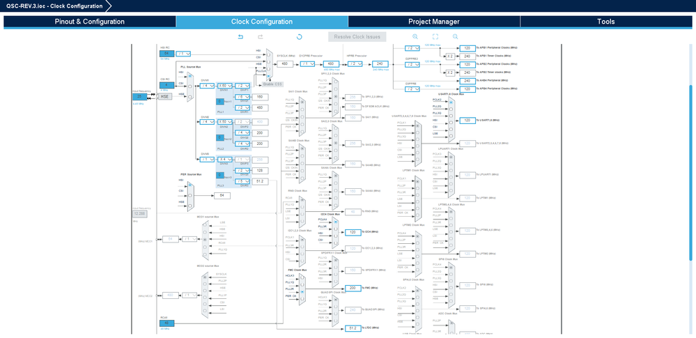

A custom board was built using the STM32H753XI. The board contains 16MB SDRAM and we want to use it with an LTDC to display a screen on a TFT-LCD.
I used the embedded wizard to create the UI and verified that it displays correctly on the LCD screen.
However, flickering occurs on the LCD when the screen is switched or parts of the screen change.
I rechecked the clock, SDRAM, LTDC settings, etc. but couldn't find the cause.
I've attached the datasheets for the parts I used as files.

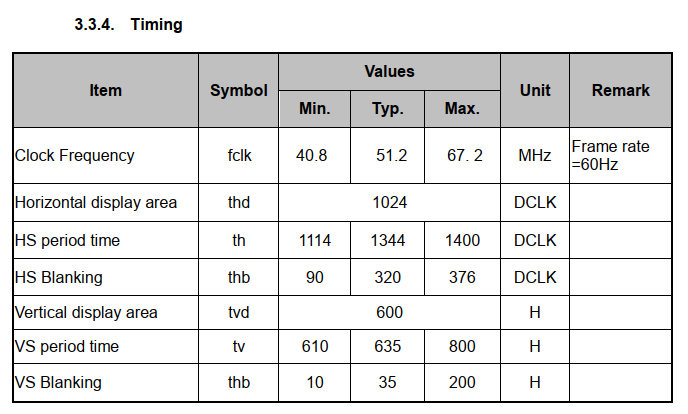

1. TFT-LCD (JWS070NA-23A-1)
- 7" TFT-LCD
- Resolution: 1024 x 600
- using LVDS ( STM32H753 (LTDC) ---- LVDS Transmiiter ----- TFT-LCD )

3. Clock configuration
- using 480 MHz
- FMC Clock: 200 MHz
- LTDC Clock: 51.2 MHz

5. LTDC
5.1. defined setting

/* Polarity configuration */
/* Initialize the horizontal synchronization polarity as active low */
hltdc.Init.HSPolarity = LTDC_HSPOLARITY_AH;
/* Initialize the vertical synchronization polarity as active low */
hltdc.Init.VSPolarity = LTDC_VSPOLARITY_AH;
/* Initialize the data enable polarity as active low */
hltdc.Init.DEPolarity = LTDC_DEPOLARITY_AL;
/* Initialize the pixel clock polarity as input pixel clock */
hltdc.Init.PCPolarity = LTDC_PCPOLARITY_IPC;
// for some reason the display content is shifted.... ??? msy
#define SHIFT 1
/* Timing configuration for LCD */
/* Horizontal synchronization width = Hsync - 1 */
hltdc.Init.HorizontalSync = 108 - SHIFT;
/* Vertical synchronization height = Vsync - 1 */
hltdc.Init.VerticalSync = 13 - SHIFT;
/* Accumulated horizontal back porch = Hsync + HBP - 1 */
hltdc.Init.AccumulatedHBP = 108 + 106 - SHIFT;
/* Accumulated vertical back porch = Vsync + VBP - 1 */
hltdc.Init.AccumulatedVBP = 13 + 11 - SHIFT;
/* Accumulated active width = Hsync + HBP + Active Width - 1 */
hltdc.Init.AccumulatedActiveW = 108 + 106 + 1024 - SHIFT;
/* Accumulated active height = Vsync + VBP + Active Height - 1 */
hltdc.Init.AccumulatedActiveH = 13 + 11 + 600 - SHIFT;
/* Total width = Hsync + HBP + Active Width + HFP - 1 */
hltdc.Init.TotalWidth = 108 + 106 + 1024 + 106 - SHIFT;
/* Total height = Vsync + VBP + Active Height + VFP - 1 */
hltdc.Init.TotalHeigh = 13 + 11 + 600 + 11 - SHIFT;

It seems you already checked this application Note : https://www.st.com/resource/en/application_note/an4861-lcdtft-display-controller-ltdc-on-stm32-mcus-stmicroelectronics.pdf
few hints to try :
1) the color format seems 16b (RGB565) : to be confirmed (if yes this excludes 1KB crossing issue described in AN4861)
2) section 4.6.1 : Disable FMC bank1 if not used .
3) to reduce pixel clock from 51MHz to 40MHz or less to see what happens .
Please let us know if you progressed on such behavior .
Cheers,
STOne-32
‎2024-03-03 4:12 PM
Thank you. Since lowering the clock to 40Mhz, it works fine.
‎2024-03-04 5:04 AM
So Most probably it seems a Bandwidth optimization . Is that possible to have the same video with 40MHz Clock ?
