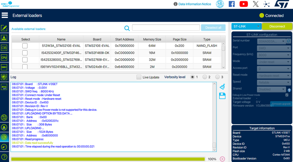

Is the MCU supposed to have some registers pre-programmed before placing on the board perhaps?
This is the screenshot from the STMCube Programmer software when the portenta H7 is connected (H7 was in the completely erased state).
(Note the 0.0V target voltage however connection is successful)
