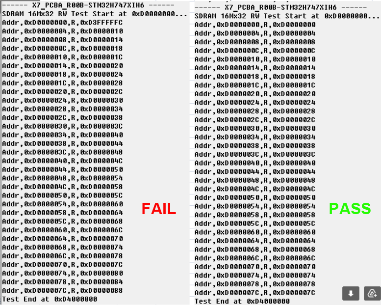

C. The issue doesn't look like random error that may be caused by hardware timing problem. The following figure shows the printed test result from one memory test:
0693W00000AMlNBQA1.pngIn this test, the address of each memory cell is converted to data and written to it.
In the passed case, memory address and read data are the same,
While in the failed case, the address and read data are shifted by 12.

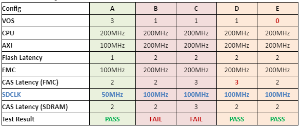

■ Some Analysis:
0693W00000AMlQAQA1.pngIn this table, Config A is 50MHz SDCLK which works fine.
Config B & C are running SDCLK at 100MHz with different CAS latency, both failed.
We do found two strange cases, with illegal settings, but actually works:
Config D is to set CAS latency of FMC and of SDRAM at different value: 3 for FMC and 2 for SDRAM (set to SDRAM mode register while initialization).
Config E is to set VOS voltage to 0. (This setting is illegal in the sense that according to data sheet, VOS 0 can only be used with LDO supply, while our board is using SMPS direct supply for VCORE power.)
