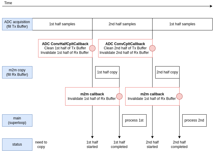

0693W00000Sv4KBQAZ.png@Piranha​ Thanks for the guidance.
Here's a diagram of what I implemented so far, hope that is clear.
(edit: spotted a typo, the 2° m2m callback invalidates the 2nd half)

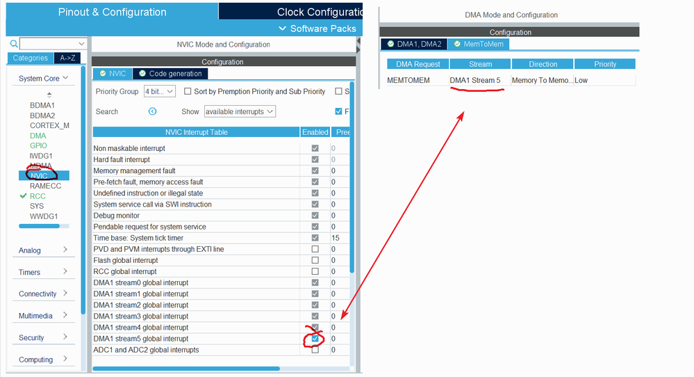

At the moment I can see that the m2m callback is never called.
Here's my code for it:
static void m2mCallback(DMA_HandleTypeDef *_hdma);
HAL_DMA_RegisterCallback(&hdma_memtomem_dma2_stream0, HAL_DMA_XFER_CPLT_CB_ID, m2mCallback);
/* Track mem2mem complete */
  if(status == SECOND_HALF_COPY_STARTED)
    /*Invalidate 2nd half of Rx Buffer (copied ADC values)*/
    SCB_InvalidateDCache_by_Addr((uint32_t *) &aADCDualConvertedValuesCopied[ADCCONVERTEDVALUES_BUFFER_SIZE/2], 4*ADCCONVERTEDVALUES_BUFFER_SIZE/2);
    status = SECOND_HALF_COPY_COMPLETED;
    BSP_LED_Off(LED_ORANGE);
  } else if (status == FIRST_HALF_COPY_STARTED) {
    /*Invalidate 1st half of Rx Buffer (copied ADC values)*/
    SCB_InvalidateDCache_by_Addr((uint32_t *) &aADCDualConvertedValuesCopied, 4*ADCCONVERTEDVALUES_BUFFER_SIZE/2);
    status = FIRST_HALF_COPY_COMPLETED;
    BSP_LED_On(LED_ORANGE);
Make sure that MEM2MEM's "dma 2 stream 0" global interrupt is enabled. In my case it was "dma 1 stream 5 global interrupt":0693W00000Sv4aiQAB.png
