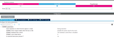

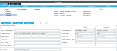

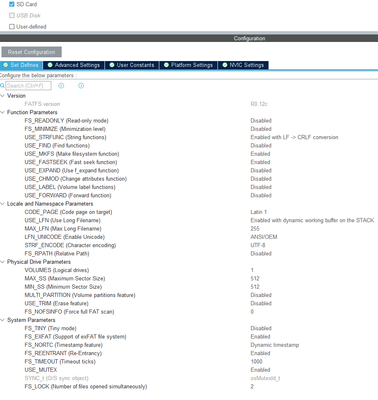

I need help because I'm going crazy.
I’m trying to use SD card with STM32H747 on the M4 core using FatFS and SDMMC1 and FreeRTOS, but the MDMA write never completes and the write complete callback is never called. This happens when I try to format the SD card with f_mkfs, f_mkfs calls SD_write, which eventually triggers HAL_SD_WriteBlocks_DMA. and in which i it crashes. Reading works OK problem occurs only in writing. Tested on many SD cards.

other config below:
