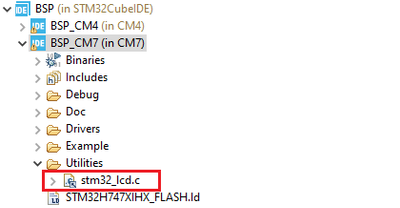

1-  Was stm32_lcd.c already included in the project?:
2- Check the availability of stm32_lcd.c under the path \Utilities\lcd\stm32_lcd.c
yes stm32_lcd.c is included in utilities folder
Included in the project as well?
yes

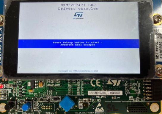

so all the lcd examples project have problems the display presents noise like the fellowing image :

Sorry, at the beginning you posted a symptom of linking issue now you said that you are running the example with an issue in the LCD display.. I'm a bit confused!
I've just run the example and it worked fine from my side:
But there is another thread which I think it describes the same symptom as yours: https://community.st.com/t5/stm32-mcus-touch-gfx-and-gui/stm32f769i-disco-really-noisy-tft-lcd-display/td-p/55127
I find the problem
the problem is the version of driver : the LCD FGRIDA FRD397B25009D-CTK replaced by  FGRIDA FRD400B25025A-CTK
