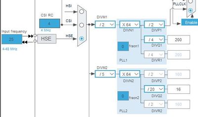

I tested using the HSE with an external crystal (Ref. below image), but the issue still persists.
Even if the issue still persist, please keep that configuration.
To avoid unnecessary ping pongs, better to share your project so we can help you efficiently.
