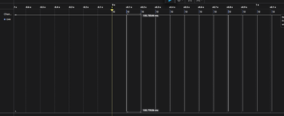

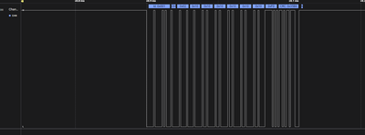

I tested your project with a little modification and there is no issue. I just connected another CAN node which is a NUCLEO-F767 board (CAN2.0) + a transceiver, and the latter is receiving the CAN frames from STM32H745I-DISCO without issues.
These are the frames send each 100ms:
This screenshot spots one frame:
A screenshot for IAR of the receiving CAN frame (F767 side) showing the Rx content changing in live (only data 0 and data 7 are changing):
Attached the projects that I used for the test.
Now, I'm pretty sure it's not a software issue and you have a hardware issue. Either with the transceiver or the wiring or something else. Maybe you swapped CAN_H and CAN_L? need to check.

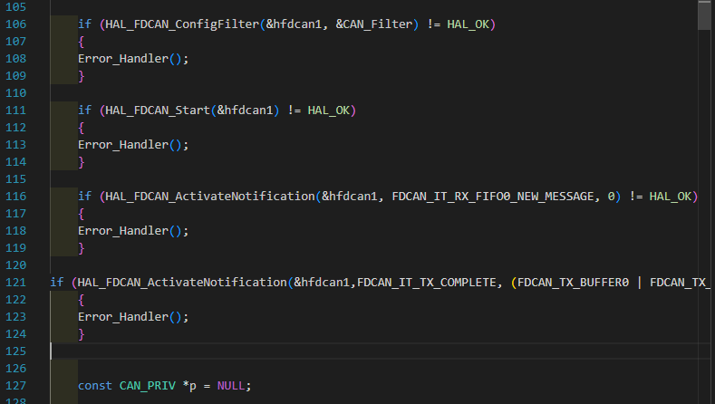

After start fdcan, the interrupt should be start
What is the clock source of your FDCAN? Did you set HSE as main clock source for FDCAN?
I was using HSI as the main clock source for FDCAN. I also tried switching to HSE as the main clock source, but the issue still persists.
I haven’t enabled any interrupts there. Do I still need to mention it?
In Normal mode you should use HSE with an external crystal as soon you are connected to another CAN node.
