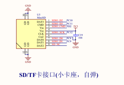

Hey,
I have a chinese STM32H743 Board, with a 25Mhz Clock Source and sdcard 3.3V VDD.
my clock settings:
my SDMMC1 config:

if you talk about the DEV-E board, H743V , i have it also :
25M clock and sd-card:
+ check: you set it using the correct pins !
Try with 1bit mode first...and set pin speed medium, withh pullups ON (on all pins);
Mine is working fine, at full speed (100M + div1) , 4 bit mode.
Hey,
Wiring works fine, the Clocksignal for the Card is fine.
I found the Problem, when i deactivate the DCache function, the SDcard works fine in 4 bit mode and 100M.
if i activate the DCache function, SDCard don't work.. is there a trick to work with SDcards and DCache? i need DCache for my ext RAM..
