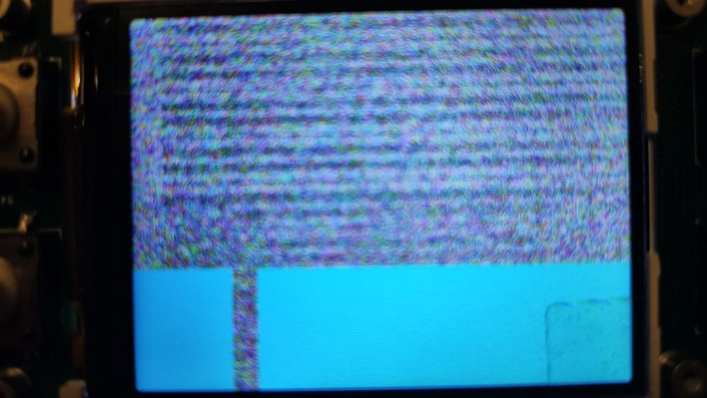

I have an STM32H743 connected to a screen that uses ST7789 via FMC (i.e. parallel connection) using 8-bit bandwidth and A18 to select between command and data.
The current code has an issue that the screen output is messed up (see pictures below) if I don't add a sleep to my write functions that uses FMC.

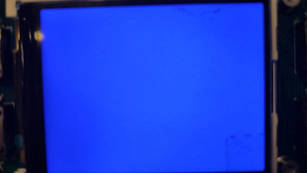

Filling the screen with the color blue without the delay in writeData produces:
With the delay (after a while since it takes 1ms per pixel) fills it correctly:

Found the issue, it was a missing volatile on the pointers to the FMC memory or as in STM32HAL syntax __IO - the code should be:
static __IO uint8_t* fmc_command_pointer = (__IO uint8_t*) COMMAND_LOCATION;
static __IO uint8_t* fmc_data_pointer = (__IO uint8_t*) DATA_LOCATION;
Now why this works in my STM32CubeIDE is a mystery, probably a gcc compile flag
