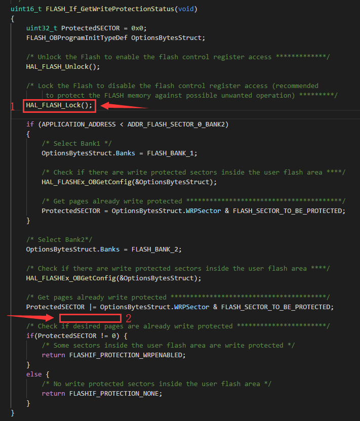

STM32H743 FLASH problem
one V
Posted on June 02, 2018 at 09:37
X:\STMicroelectronics\STM32Cube\Repository\STM32Cube_FW_H7_V1.2.0\Projects\STM32H743I_EVAL\Applications\IAP\IAP_Main
Isn't function HAL_FLASH_Lock() supposed to be in position 2?

In addition, by the way, I use the example of IAP provided in STM32Cube_FW_H7_V1.2.0\Projects\STM32H743I_EVAL\Applications\IAP\IAP_Main\, but the loaded APP program can not run. The APP code I have set the interrupt vector table and jump address.
GreenGuy
Lead
Thank you for pointing this out. I was wondering why after the erase function call, the memory was not erased. I move the Lock function down to:
and now the flash erase works.

AHHHH!
uint16_t FLASH_If_GetWriteProtectionStatus(void)
 uint32_t ProtectedSECTOR = 0x0;
 FLASH_OBProgramInitTypeDef OptionsBytesStruct;
 /* Unlock the Flash to enable the flash control register access *************/
 HAL_FLASH_Unlock();
// /* Lock the Flash to disable the flash control register access (recommended
//    to protect the FLASH memory against possible unwanted operation) *********/
// HAL_FLASH_Lock();
 if (APPLICATION_ADDRESS < ADDR_FLASH_SECTOR_0_BANK2)
   /* Select Bank1 */
   OptionsBytesStruct.Banks = FLASH_BANK_1;
   /* Check if there are write protected sectors inside the user flash area ****/
   HAL_FLASHEx_OBGetConfig(&OptionsBytesStruct);
   /* Get pages already write protected ****************************************/
   ProtectedSECTOR = OptionsBytesStruct.WRPSector & FLASH_SECTOR_TO_BE_PROTECTED;
 /* Select Bank2*/
 OptionsBytesStruct.Banks = FLASH_BANK_2;
 ProtectedSECTOR |= OptionsBytesStruct.WRPSector & FLASH_SECTOR_TO_BE_PROTECTED;
 HAL_FLASH_Lock();
 /* Check if desired pages are already write protected ***********************/
 if(ProtectedSECTOR != 0)
   /* Some sectors inside the user flash area are write protected */
   return FLASHIF_PROTECTION_WRPENABLED;
 else
   /* No write protected sectors inside the user flash area */
   return FLASHIF_PROTECTION_NONE;
Someday I figure out how you guys are doing that.
 HAL_FLASH_Unlock();
   /* Select Bank1 */
 /* Select Bank2*/
 HAL_FLASH_Lock();
 else
