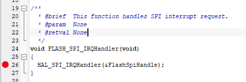

I'm working on STM32H743 applied SPI DMA with MT25 QL128ABA1(NOR Flash) and initial mode to master mode.
My problem is I cannot receive (HAL_SPI_Receive_DMA) return data when I use HAL_SPI_Transmit_DMA by run code through but I can receive return data when I apply breakpoints before HAL_SPI_IRQHandler. I probe to confirm return data already.
The Nor flash must transmit command first and then receive return data later.
Note: I try to transmit data by using HAL_SPI_TransmitReceive_DMA then receive data by HAL_SPI_Receive_DMA it work!! but I want to know why I cannot use HAL_SPI_Transmit_DMA .
