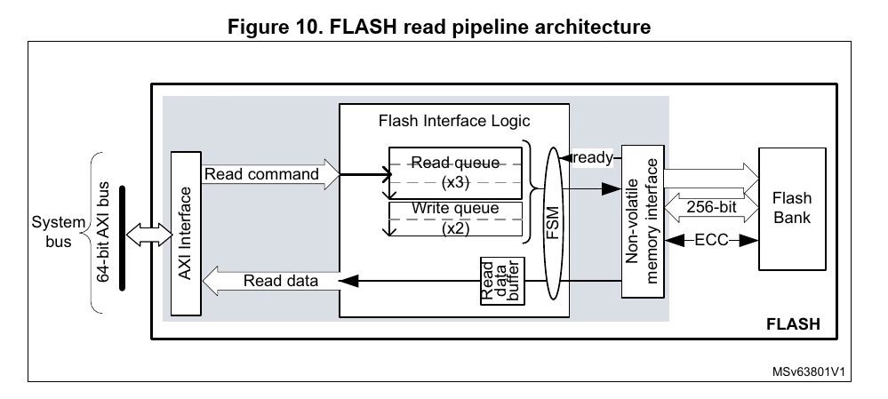

* how many 4-byte f32 transfers can I expect per m7 core clock tick using DMA from dram to dTCM
The AXI bus is clocked at core speed (afaik) , so 1 clk -> 1 32b transfer . (maximum- if "nobody" else requesting the bus, maybe cpu or other DMA...)
* how many 4-byte f32 transfers can I expect per m7 core clock tick using DMA from flash to dram
Depends on size of transfer, flash is accessed 256b wide, at 3WS (4 clks) at max. speed (550MHz);
so 4 clks for first , then 1 clk next 7  x 32b words.
see rm.
If D-cache enabled and cache line loaded, then maybe without any waitstates .
But anyway : try a simple test, then you know.

Thanks; that does indeed go into some more detail: I like this part
`It is split into two DTCM-RAMs with 32-bit access each. Both memories are connected respectively to the D0TCM and D1TCM ports of the Cortex®-M7 (not represented in the figures) and can be used in parallel (for load/store operations) thanks to the Cortex®- M7 dual issue capability`
So it seems I could load an f32 matrix and vector component in a single cycle if both are stored in different DTCM banks. Which low-key contradicts what I read about the FMAC; but that might have been an FMAC specific limitation then.
Piecing together all the tidbits of information ive found, it seems to me that someone who knows exactly what they are doing could get one fused-multiply-add per cycle out of the stm32h7... but I also suspect that its going to be a lot of work to get there, manually orchestrating all the memory management from flash to ram to TCM to core. Writing a single matmul-benchmark might not be too much work; but actually tying it together into an actual neural network would probably end up a little like writing your own cube.ai code generator.
