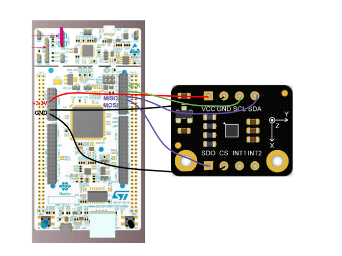

To test the communication between my microcontroller and my accelerometer, I try to read the WHO_AM_I register of the LIS2DW12. This register is a read-only register. Its value is fixed at 44h. Unfortunately I can't read this value but I read FFh. First of all, so that you can confirm that I haven't made an error of connection, here's how I connected my accelerometer to my nucleo-board :
Accelerometer connections.pngI just connected the accelerometer to the supply (+3.3V & GND) and the 4 SPI wires.

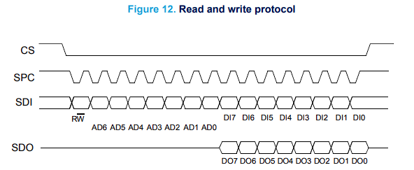

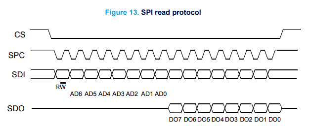

I wrote a simple code to read value of the register WHO_AM_I using the function HAL_SPI_TransmitReceive.  According to the datasheet, to read this register (address 0Fh), it must be sent a byte with the value of the address register and a 1 as MSB -> 8Fh.

Is this the second ground wire to set nCS on external SPI slave low (all the time)?
Are you sure the external chip works with hold nCS all the time low? (many chips want to see a new nCS cycle,
and even they would allow to let nCS all the time low: after this chip comes out of reset and nCS is already low - the chip has no clue about "where we are in the protocol").

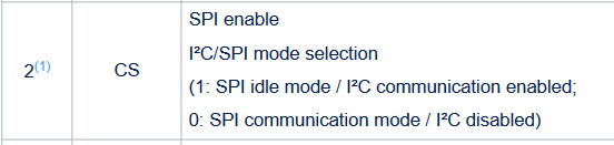

Yes, I connected a ground wire to set nCS on external SPI slave low all the time. On the datasheet, it is indicated that the CS pin must be 0 to use the SPI interface, and 1 for i2c. It's the reason why I connected it to a ground wire to have 0 on CS.
But in reality, the accelerometer want to see a new nCS cycle as you told me. I had already tried to connect CS to a GPIO before my post but it didn’t work. I try again and now it's working ! So the first time, I think I tried with another SPI configuration (which was wrong). Thank you for your advice !
