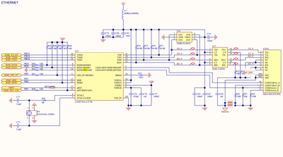

As the subject states I am trying to get Ethernet work on the VET6 Microcontroller. I have tried to configure my microcontroller like the Ethernet example project provided on Github for the STM32H723GT. I have tried the exact code on the H723GT Nucleo Board and it instantly works. The only changes I made were the Heap for FREERTOS which i changed to heap3 and I configured ip-adress etc. to my needs. However when I configure the VET6 with the same parameters it doesnt work. I dont get any errors when flashing the program on the microcontroller, but when I debug the code the programm runs into a hardfault error during the configuration of LWIP. I have already tried reconfigurating the memory in CubeMx, but this doesnt work either. I have also read that I have to reconfigure the memory in the flash script, but by changing the adresses of Rx descriptor etc. in the flash script i can't even build the code.
I think I have tried all the things that are mentioned in the README for STM32H723GT, but it doesnt work. Please comment if anyone can find a solution to this issue. Im sure that it is some sort of memory issue, but I cant fix it.

you mentioned that you used the STM32H723VET6 is it a custom PCB design of your Board ?
also it might be helpful to share the modification done to the linker file as the STM32H723VET6 has the same RAM size with STM32H723ZG the only difference resides in the Flash size which should not affect the placement of the descriptors in the RAM which i think should remain the same .
make sure you have the correct pins assigned to Ethernet maybe check the schematics for the default solder bridge configuration :

Hi its a custom Board and I somehow was able to fix it by adding
#if defined ( __ICCARM__ ) /*!< IAR Compiler */
#pragma location = 0x30000200
extern u8_t memp_memory_RX_POOL_base[];
#elif defined ( __CC_ARM ) /* MDK ARM Compiler */
__attribute__((at(0x30000200)) extern u8_t memp_memory_RX_POOL_base[];
#elif defined ( __GNUC__ ) /* GNU Compiler */
__attribute__((section(".Rx_PoolSection"))) extern u8_t memp_memory_RX_POOL_base[];
#endif
in the ethernetif.c file and
.lwip_sec (NOLOAD) :
. = ABSOLUTE(0x30000000);
*(.RxDecripSection)
. = ABSOLUTE(0x30000100);
*(.TxDecripSection)
. = ABSOLUTE(0x30000200);
*(.Rx_PoolSection)
} >RAM_D2
in the flash.ld file. I tried to add this to the flash script before, however it didnt work then.
By adding the code above in the ethernetif.c file I was able to fix it. Pinging the board works perfectly and I can also execute the code in the StartDefaultTask.
